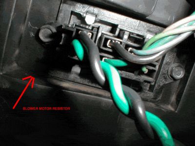

the blower motor only works on the highest speed, which is 4. there are four speeds 1 ti 4 for both heaty and air

Replace your blower motor resistor.
https://images.2carpros.com/forum/automotive_pictures/55316_blowerrepair_5.jpg
