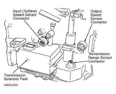

part is avail, how do I remove the trans shift solenoid, located on the front of the trans under the car.

Below is the info you requested. Remove any components that may be in the way of easy access. Clean the area very well so that sand or dirt does not fall into the holes after you remove the solenoid pack. Remove the bolts holding the solenoid pack down. Remove the solenoid sensor wire. Remove any remaining dirt before installation.
https://images.2carpros.com/forum/automotive_pictures/261618_Graphic_3.jpg
Reverse for installation.

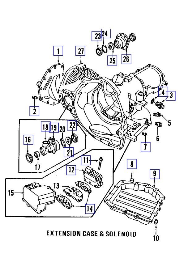

Where are the bolts that hold the solonoid down? are they on top or bottom of the solonoid? do you have any pictures to send for the situation?

Picture is above in previous post.
I could not find, in my resources, the exact positioning of the bolts but I will ask a fellow tech and get back with you on this in just a few minutes.

Sorry took so long. Below is exploded diagram. #15 Larger diagram below
