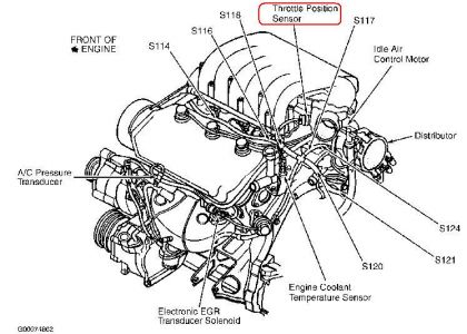

WHERE IS THE TPS LOCATED AND HOW HARD IS IT TO CHANGE

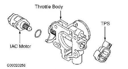

Hello Your throttle position sensor is located on the throttle body (see figure below) . Removal/installation instructions are listed below for your review. If you feel you are not capable of doing this repair, please let an experienced repair shop do it for you to prevent damage to vehicle or harm to self.

PLEASE NOTE: The instructions below are for the Sebring Coupe, NOT the Sebring Convertible. If your vehicle is the Convertible style, please let me know as the instructions are slightly different.
