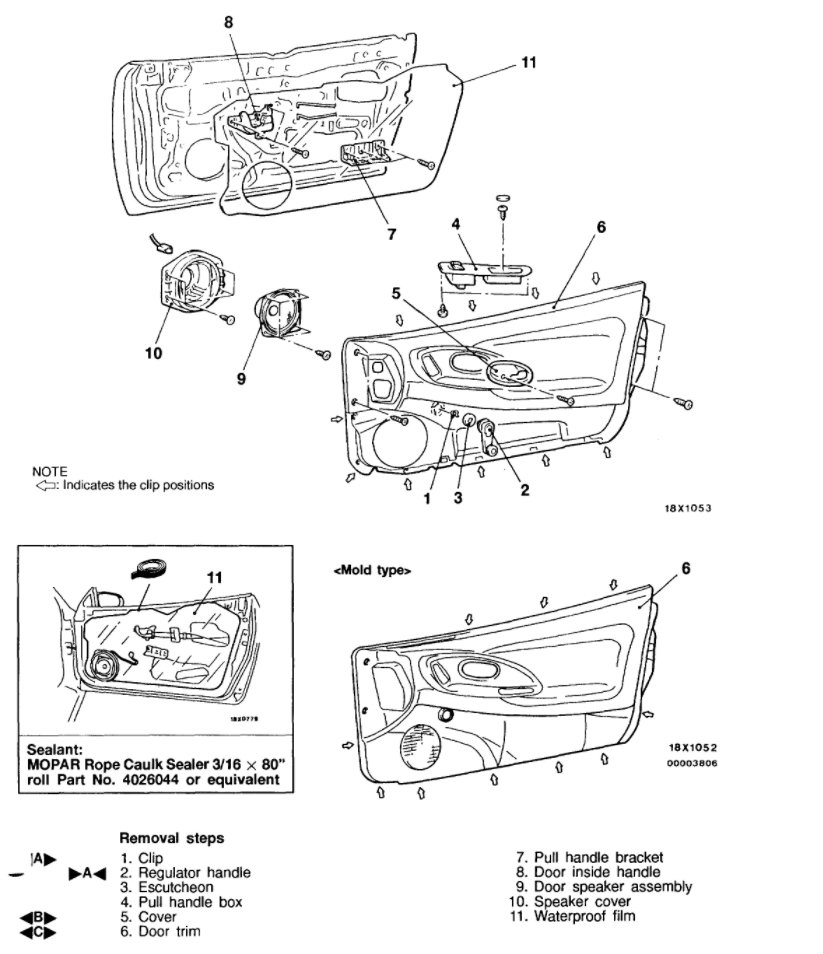

Why is the alarm arming itself, even though i did not lock the doors. how do i disarm it. it wont let me start the car. Even when i use the key to unlock it?

It sounds like you have a drivers door latch that is no good which will cause the alarm to arm itself and then get locked up. There is a micro switch inside the latch that goes bad.
Here is a diagram to show you what you are in for when fixing the problem.

You nailed it me friend I got the part for $58.00 and installed it now the car works great!.. I love this site and for free, how refreshing.

[quote:c0387546c7]Thanks zack, it was the ETACS-COMPUTER and the car is convertible. i went to the salvage yard and bought one. it worked-out fine.
and thank you guys for this site, if my car could talk it would probably say thanks for saving it from a gallon of gas and a box of matches once again THANKS.[/quote:c0387546c7]
You are welcome. I am glad that everything worked out fine.
