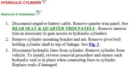

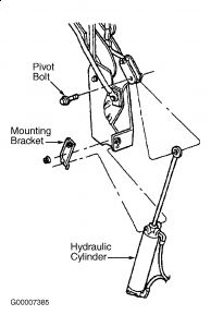

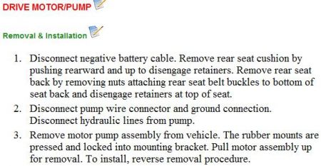

I think I have a leak in my convertible hydraulics system. Can you tell me where I can access the components to check them?
