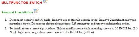

Do I have to remove the steering wheel to change the wiper switch?
Jul 23, 2009 at 7:18 PM
BLUELIGHTNIN6
  • 16,542 POSTS
No, replacement procedures are below..

BRIGHTON85
1999 Chrysler Sebring, my wiper switch is located on the right side of the steering wheel and runs just the windshield wipers and the washers no turn signal or anything else...how do I change it?

previous steps was for the Sebring...
Is this a coupe or convertible model?

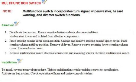

BRIGHTON85
[quote:d68a1c68c9="bluelightnin6"]previous steps was for the Sebring...
Is this a coupe or convertible model?[/quote:d68a1c68c9]
It's a convertible and I'm a girl and no nothing

try these steps, its still showing as being called a multi-function switch for the covertible.

BRIGHTON85
Ok so I messed up when I bought the switch for my wiper, apparently it is one big component, the wipers and washers on the right side of the steering wheel and the headlights, dimmers, and blinkers on the left, My problem is I can't find a replacement..any suggestions?

try searching local salvage yards for a used switch or on sites such as eBay.com and craigslists.com . you can usually find good deals on used parts that still function properly
