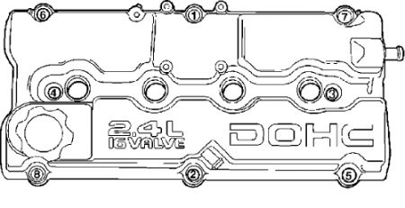

Hi, what would be the proper foot pounds torque on bolts and tightening sequence on a 1999 chrysler sebring lxi?

Hello, Here is a guide that will help you step by step to get the job done and th specs below. https://www.2carpros.com/articles/replace-valve-cover-gasket 2.4L engine 105 inch lbs
https://images.2carpros.com/forum/automotive_pictures/261618_0996b43f80204a85_1.jpg

The 2.5 v6 that year gets 88in-lbs on the valve cover bolts. The above spec is for the four cylinder.
