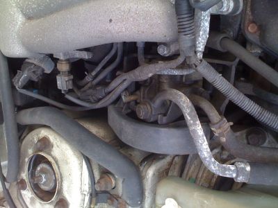

1998 Chrysler Sebring PUMP WATER
MIGUEL CUENCA
  • 1998 CHRYSLER SEBRING
  • 6 CYL
  • 2WD
  • 110,000 MILES
HOW I FIX HO CHANGE
http://www.2carpros.com/forum/automotive_pictures/270304__2.jpg

Jack up the car.
Remove tire.
Remove splash shield.
Remove drive belts.
Remove the crank pulley
Put a jack under the motor.
Remove front engine mount.
Remove the timing covers (you may have to move the P/S pump out of the way).
Remove the timing belt, remove the water pump, and reinstall. Make sure that the o-ring in the back of the water pump seats in properly before you bolt it up. It is advisable that you replace the timing belt at the same time.
