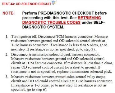

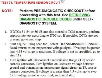

my wifes 97 chryler serbring won't shift higher than 2nd gear. whats wrong and is it something I could fix
Mar 26, 2009 at 9:02 AM
ZACKMAN
  • 4,202 POSTS

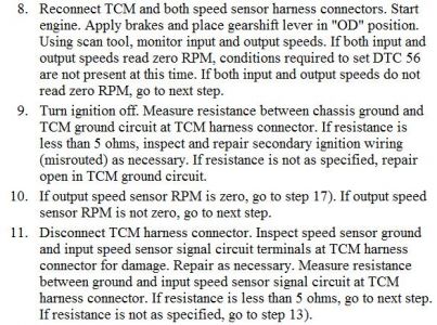

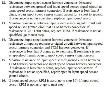

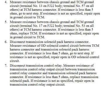

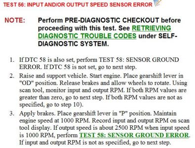

The transmission has entered "limp-home mode". Your check engine light should be on right now. Have the computer scanned and post the code numbers here\, and we will help diagnose.
Mar 28, 2009 at 3:12 PM
ABETTENCOURT
43, 31,74. and as far as the check engine light it never lit up since we got the car. so i wanted to see what the deal was i took apart the cluster and found that someone had taken the light out. so i have no idea how long the light "should have been on". I'm wondering if I should come back at eh dealer that sold it to me for not making sure the light worked or not?
Mar 28, 2009 at 3:35 PM
ZACKMAN
  • 4,202 POSTS

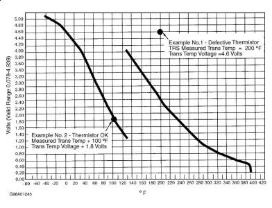

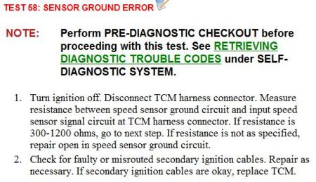

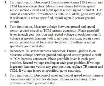

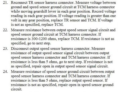

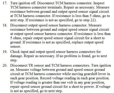

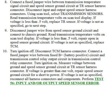

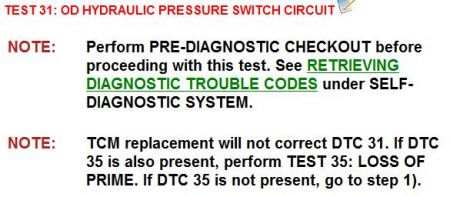

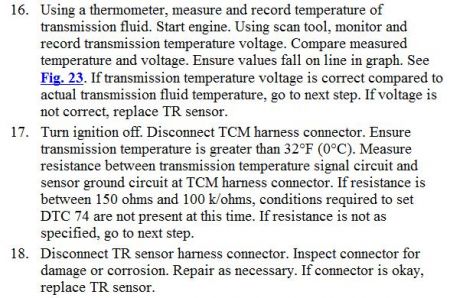

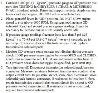

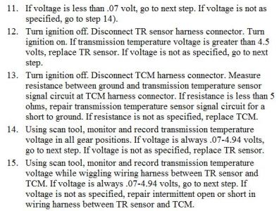

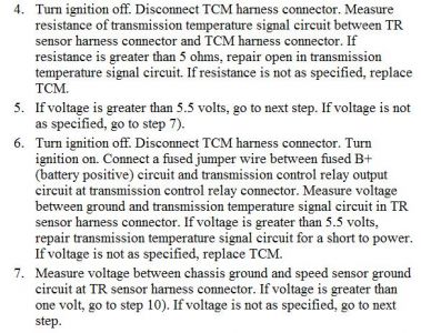

It is unfortunate that someone just wants to make a buck at the expense of others. I have seen MIL bulb pulled out a few times, drivers didn't know about it until time for state safety/emission inspections. DTC explained. 31 O/D Hydraulic Pressure Switch 43 O/D Solenoid Circuit 74 Calculated Oil Temperature In Use You can perform most of the diagnostic yourself if you are handy with voltmeter and most hand tools.
