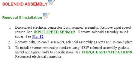

My OBD2 scanner is bringing up PC182 and it says it is 24 pressure switch. The car sometimes stays in 2nd gear and will not shift up or down, and sometimes it is ok. I need info on how I can fix it or would it be cheaper to replace it with a used $525 transmission?

I don't have info on the manufacture specific code, but the pressure switch is part of the solenoid assy.
https://www.2carpros.com/forum/automotive_pictures/30961_cs1_1.jpg
https://www.2carpros.com/forum/automotive_pictures/30961_cs2_1.jpg
https://www.2carpros.com/forum/automotive_pictures/30961_cs3_1.jpg

Sorry the code is P1782 if that makes any diff
