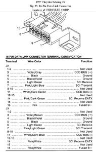

I can't use a obd scanner because it won't power up when connected to the DLC . would you have an image of the 97 sebring dlc so i can tell which is pin 1 and pin 4 . i can't see in the position it is in. what fuse is used for the DLC. maybe the reason it won't power up the scanner. all fuses good, still no power to dlc.please HELP

https://images.2carpros.com/forum/automotive_pictures/192750_DLCIdentification97SebringFig33_1.jpg
Seems the system is in test mode and the lights would be flashing. The scanner not powering up could be due to a missing power supply of terminal #16. Check Fuse # 5 ( 10 A) in left side dash fuse box,

all fuses and fusable links are good, there is voltage to the pin #16 (dlc), but it will not connect to the scanner so i can read the codes. could this problem be with the (ecm) ?

Did you try using a different scanner? When the scanner does not power up with battery voltage present at terminal # 16, it could be a faultr with the scanner. Check Terminal # 4 for continuity to ground.

Did you test terminal #4 for continuity to body grpound?
Vehicle is equipped with self diagnostics. Check if it is possible to retrieve trouble codes with it.
