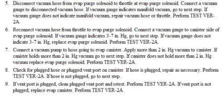

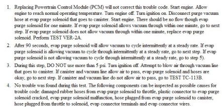

This will be the third time this code has popped up, I cleared it 3 times because I cant find a problem. Its PO441 Evap Purge Valve Incorrect Flow, The MIL is on right now and I'm not going to clear it until I'm sure what the deal is, Any ideas?

Check the following..

EVAP PURGE FLOW MONITOR FAILURE
1.Start engine. Allow engine to reach normal operating temperature. Turn engine off. Turn ignition on. Disconnect purge vacuum hose at evap purge solenoid that goes to canister. Start engine. There should be no flow though evap purge solenoid for one minute. If evap purge solenoid allows vacuum through within one minute, go to next step. If evap purge solenoid does not allow vacuum through within one minute, replace evap purge solenoid. Perform TEST VER-2A.
2.After 90 seconds, evap purge solenoid will allow vacuum to cycle intermittently at a steady rate. If evap purge solenoid is allowing vacuum to cycle through intermittently at a steady rate, go to next step. If evap purge solenoid is not allowing vacuum to cycle through intermittently at a steady rate, go to step 5).
3.During this step, DO NOT use more than 5 psi. Turn ignition off. Attempt to blow air through vacuum line that goes to canister. If canister and vacuum line allow air to pass, evap purge solenoid and hoses are okay, go to next step. If canister and vacuum line do not allow air to pass, go to TEST TC-113B.
4.No trouble was found during this test. The following components can be inspected as possible causes for trouble code: damaged rubber hoses from evap purge solenoid to throttle, plastic connector to evap purge solenoid cracked, evap purge solenoid malfunction, hose plugged from evap purge solenoid to canister, hose plugged from throttle to solenoid, evap connector terminals and evap connector wires.
5.Disconnect vacuum hose from evap purge solenoid to throttle at evap purge solenoid. Connect a vacuum gauge to disconnected vacuum hose. If vacuum gauge indicates manifold vacuum, go to next step. If vacuum gauge does not indicate manifold vacuum, repair vacuum hose or throttle. Perform TEST VER-2A.
6.Reconnect vacuum hose from throttle to evap purge solenoid. Connect a vacuum gauge to canister side of evap purge solenoid. If vacuum gauge indicates 3-7 in. Hg, go to next step. If vacuum gauge does not indicate 3-7 in. Hg, replace evap purge solenoid. Perform TEST VER-2A.
7.Connect a vacuum pump to hose going to evap canister. Apply more than 2 in. Hg vacuum to canister. If canister holds more than 2 in. Hg vacuum go to next step. If canister does not hold more than 2 in. Hg vacuum replace evap purge solenoid. Perform TEST VER-2A.
8.Check for plugged hose or plugged vent port on canister. If hose is plugged, repair as necessary. Perform TEST VER-2A. If hose is not plugged, go to next step. 9.If vent port is plugged, clean plugged vent port and retest. Perform TEST VER-2A. If vent port is not plugged, replace evap canister.
