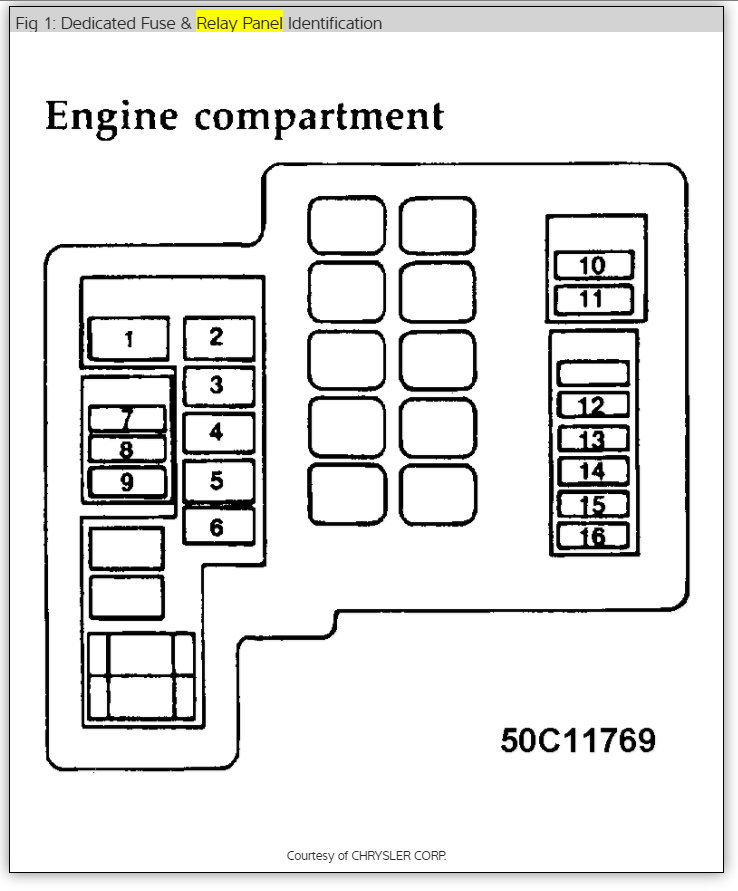

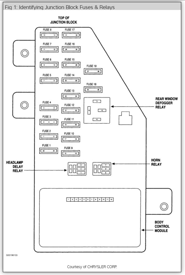

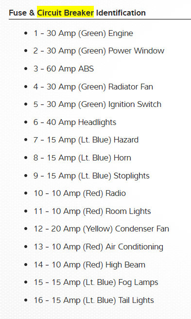

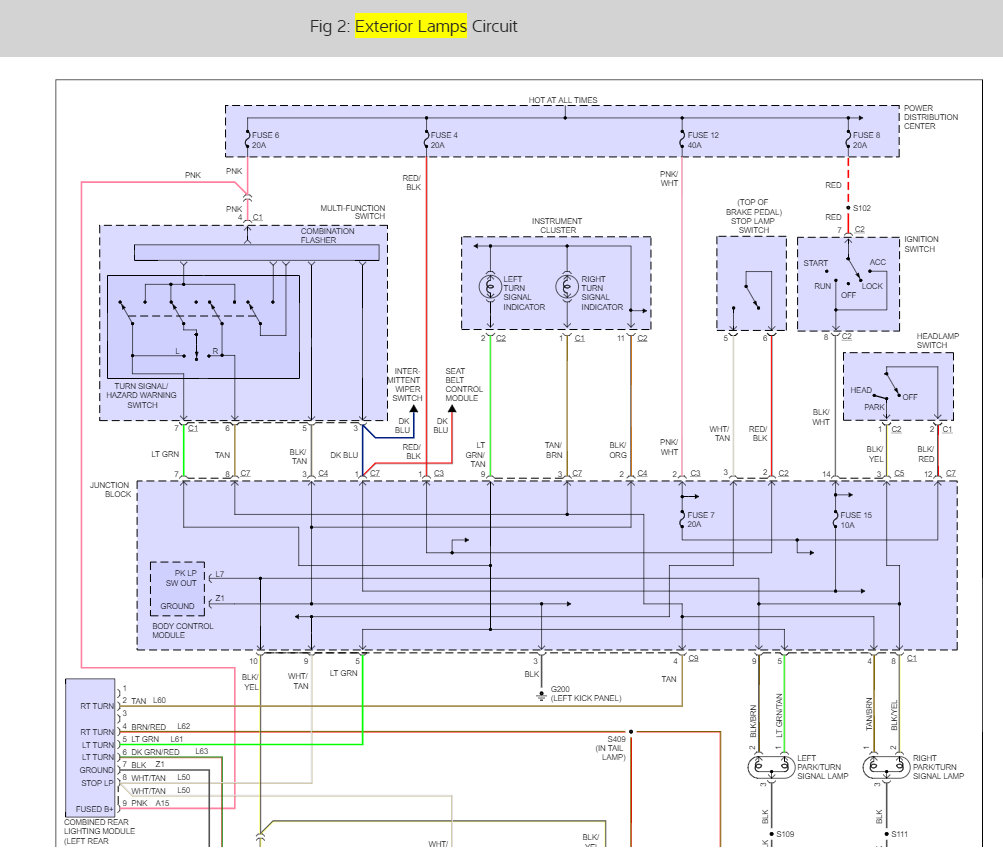

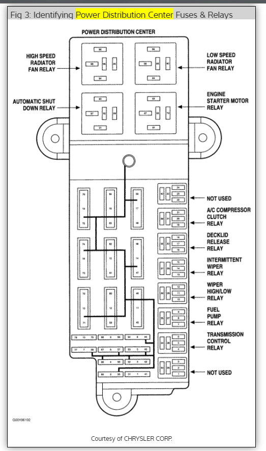

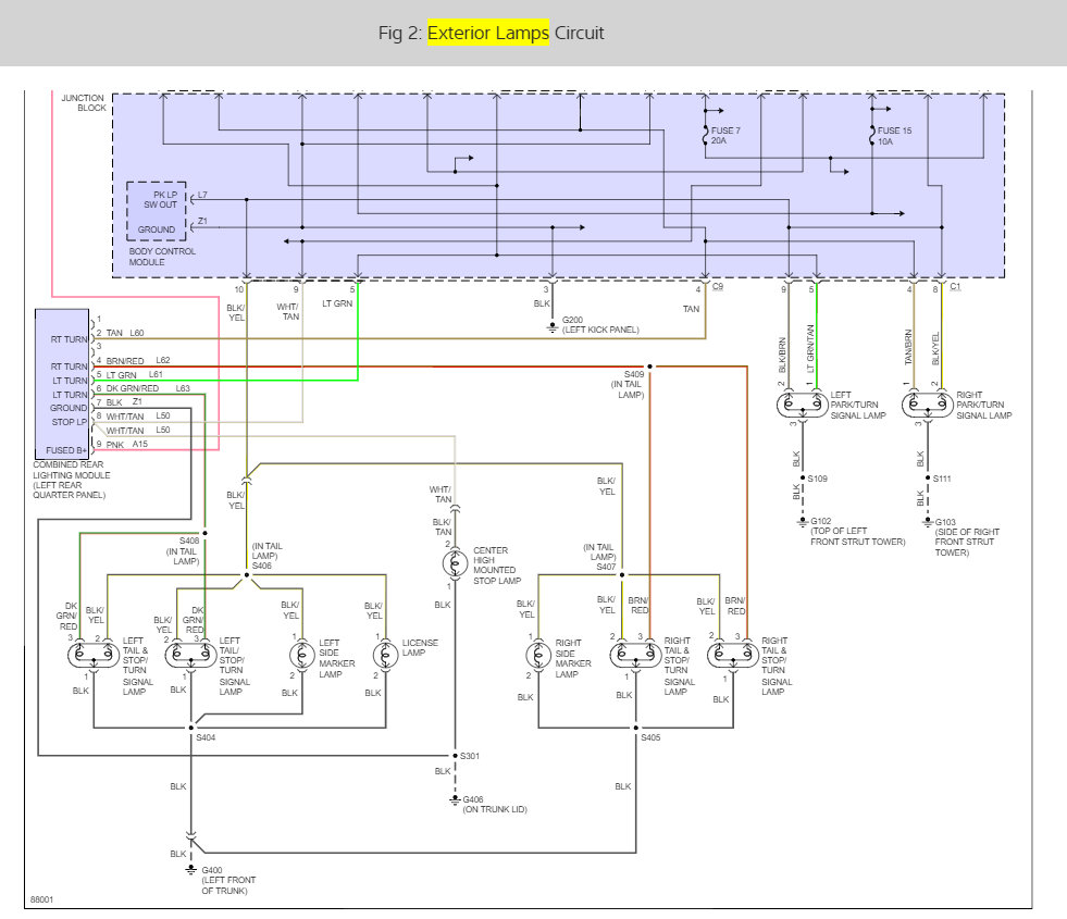

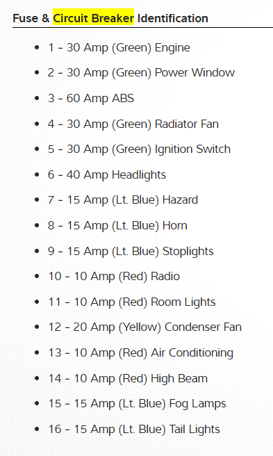

where do you find the blinker relay and or fuse? They lost the owners manual and no of the relays or fuses are marked.
Friday, September 3rd, 2010 AT 4:48 AM
KEN L
MASTER CERTIFIED MECHANIC
50,317 POSTS
Yes there is a fuse and a relay here are some guides and blinker wiring diagrams and fuse panel legends
and
The flasher is part of the blinker switch.
