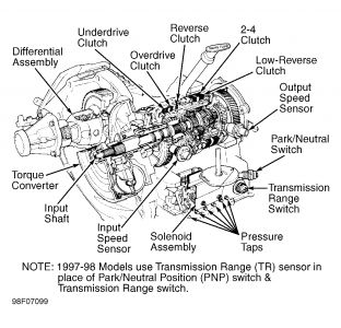

HI, CAN YOU TELL ME WHERE THE NEUTRAL SAFETY SWITCH IS LOCATED ON A 1997 CHRYSLER SEBRING?

F4AC1 transmission in 97 Sebring does not come with Neutral Safety Switch. It rather comes with Transaxle Range Sensor (TRS) located inside the transmission pan, on top of the valve body. If TRS is bad, replace the entire valve body.
https://images.2carpros.com/forum/automotive_pictures/55316_41te_1.jpg
