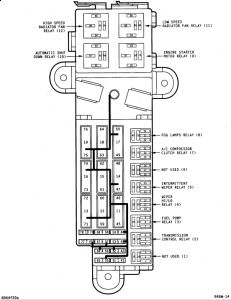

1996 Chrysler Sebring 6 cyl Two Wheel Drive Automatic
where is coolant fan relay located found relays in fuse block underhood dont know which one

Radiator Cooling Fan Motor Relay Radiator Fan (HI 1, HI 2 & LO), Condenser Fan (HI & LO) Relays

Feb 1, 2010 at 7:47 AM
ELANTRA2004
have sebring conv.fuse block looks diff.thanx good reply

1996 Chrysler Sebring Convertible V6-2.5L SOHC 24 Valve Radiator Cooling Fan Motor Relay Power Distribution (Part 1 Of 4)
https://images.2carpros.com/forum/automotive_pictures/12900_cfc1_1.jpg
High Speed Fan Relay
https://images.2carpros.com/forum/automotive_pictures/12900_cfc2_1.gif
Low Speed Radiator Fan Relay
https://images.2carpros.com/forum/automotive_pictures/12900_cfc3_1.gif
Sorry about that,you didn't mention on your first post that it was a convertible.
