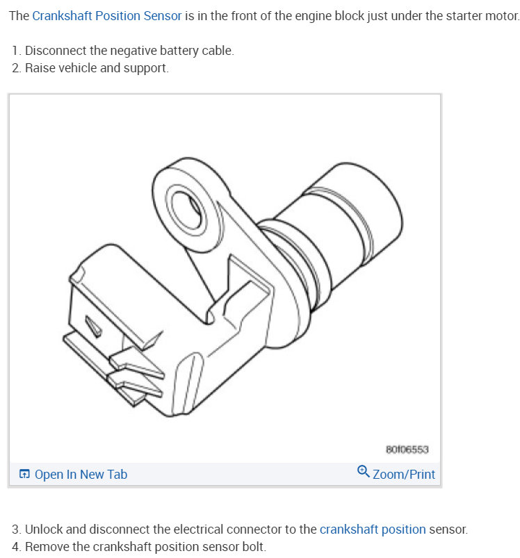

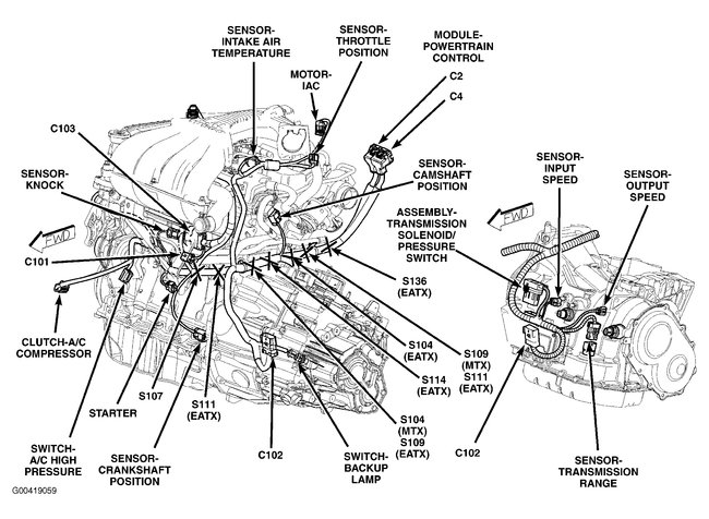

where is the crankshaft sensor located and how do you change it?
Apr 25, 2010 at 6:11 AM
DOCFIXIT
  • 18,828 POSTS

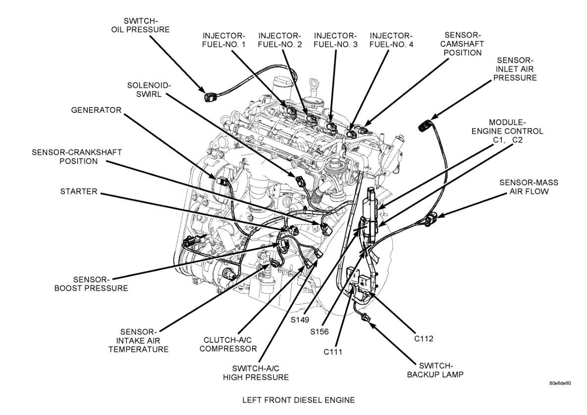

Here is a guide to help you step by step with instructions in the diagrams below to show you how on your car (below)

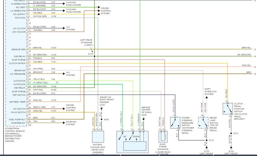

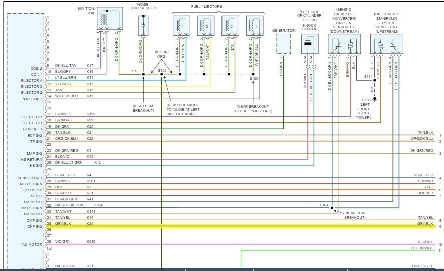

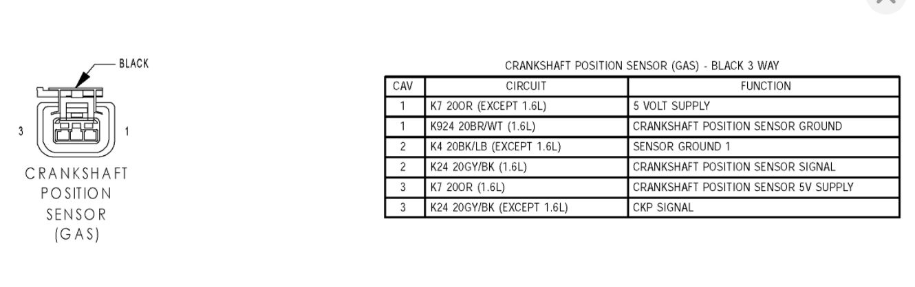

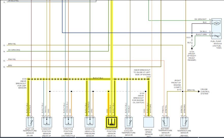

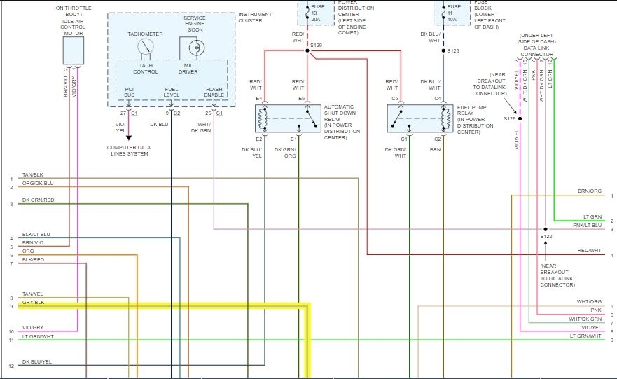

I need tire rim on the wires to his crankshaft sensor I had to put a big tail on need to make sure I'm right on color.
Feb 16, 2021 at 4:28 PM
I attached a connector diagram as well as the wiring diagram for the crank sensor for you to review.
The colors and locations are marked.

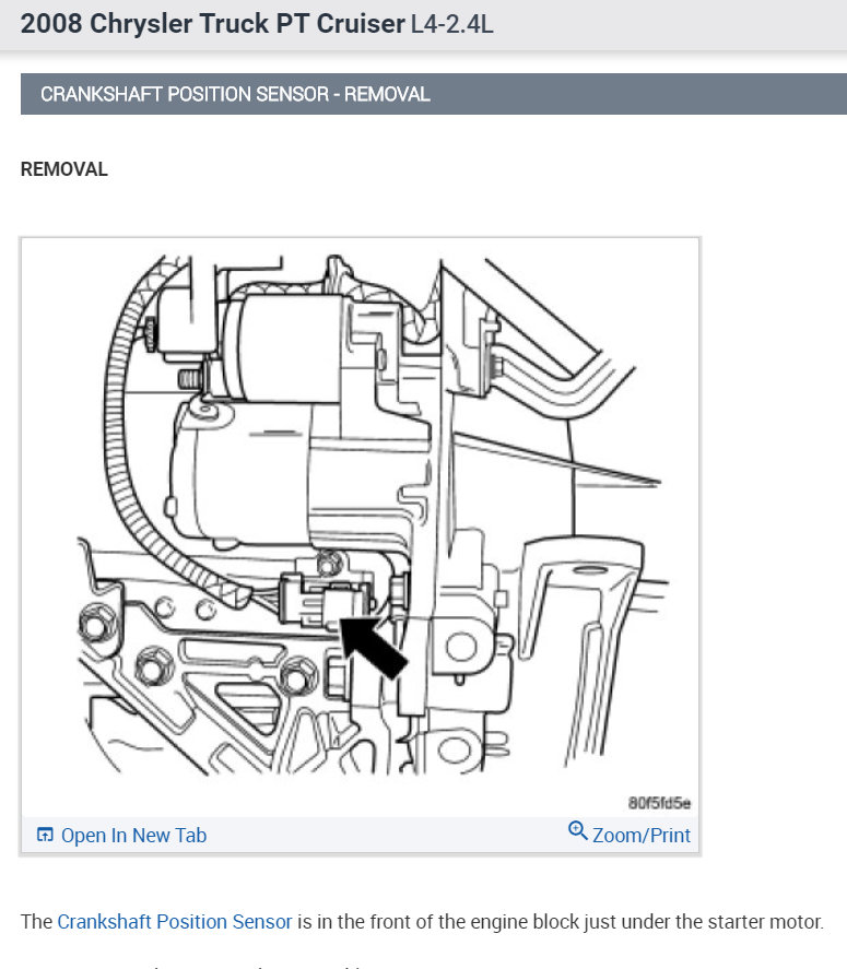

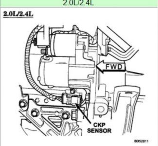

For the gas engine, it's in the front, right under the starter motor. It has three wires in the connector.

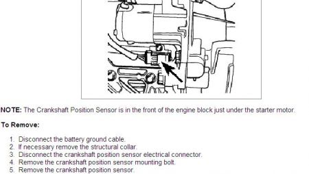

where can i locate the crankshaft position sensor and can i have a picture?
Apr 3, 2021 at 5:17 AM (Merged)
  • 75,992 POSTS

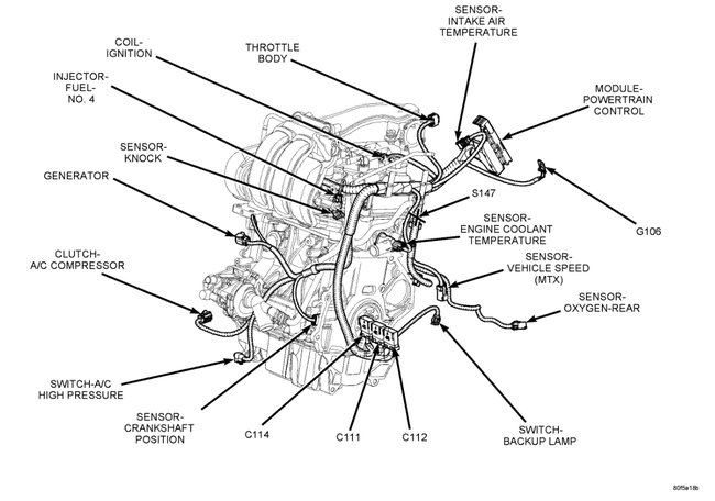

The Crankshaft Position Sensor is in the front of the engine block just under the starter motor.
https://images.2carpros.com/forum/automotive_pictures/12900_cps1_12.jpg

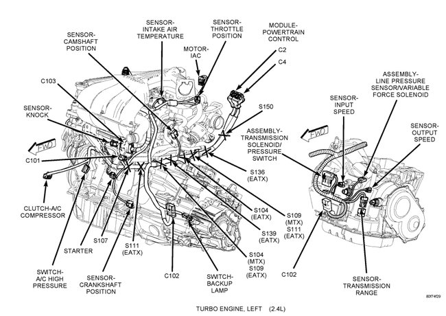

Engine light comes on, car sputters , diagonistic machine says it's crankshaft position sensor, is that hard to replace? and where is it on the engine?
RACEFAN966
  • 5,029 POSTS

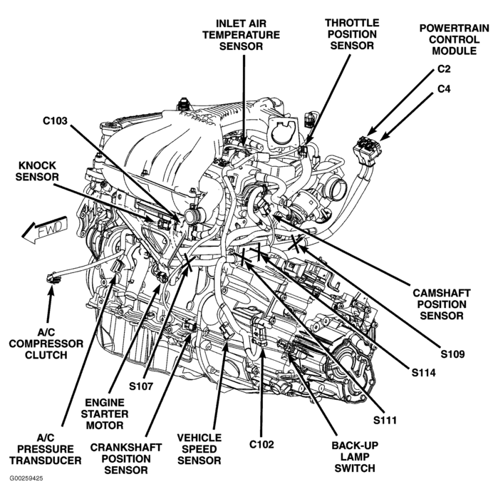

It is on the right side of the engine block use picture included. I do not know how hard it will be to get to, as it does not give me any time on replacing it. Check out the diagrams (Below). Please let us know what happens.

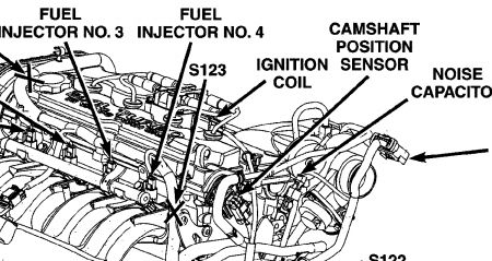

Where is the camshaft position sensor.? I want to replace it on my own.
Apr 3, 2021 at 5:19 AM (Merged)
BMRFIXIT
  • 19,053 POSTS
Hi Joe Check this. Let me know.
https://images.2carpros.com/forum/automotive_pictures/99387_camsensor_3.jpg

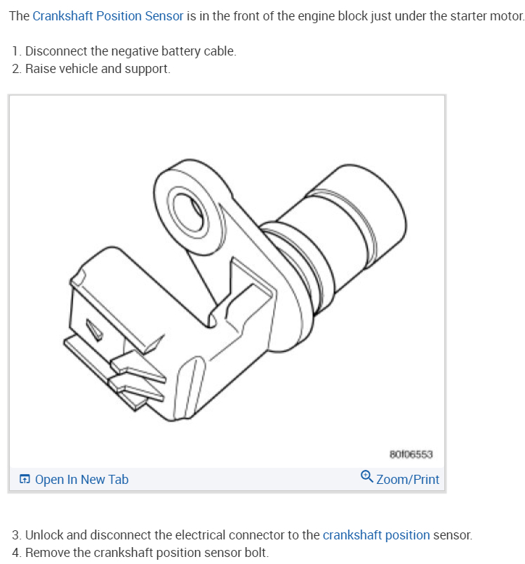

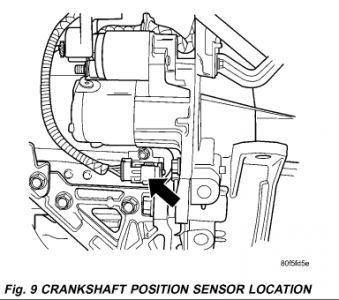

Location of crankshaft position sensor and how to change it.
  • 75,992 POSTS
https://images.2carpros.com/forum/automotive_pictures/12900_cs_4.jpg
The crankshaft position sensor is in the front of the engine block just under the starter motor. Removal: 1.Disconnect the negative battery cable. 2.Raise vehicle and support. 3.Remove the structural collar, refer to the engine, structural collar removal and Installation. 4.Unlock and disconnect the electrical connector to the crankshaft position sensor. 5.Remove the crankshaft position sensor bolt. 6.Remove the sensor. Installation - 2.0/2.4/2.4L Turbo: 1.Check o-ring for damage and lubricate the o-ring with engine oil before installing sensor. 2.Use a twisting motion when installing the sensor. 3.Install and tighten the crankshaft position sensor bolt and tighten to 9 Nm (80 ±15 in. lbs.) . 4.Connect and lock the electrical connector to the crankshaft position sensor. 5.Install the structural collar, refer to the engine, structural collar removal and installation. 6.Lower vehicle. 7.Connect the negative battery cable.
