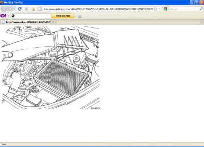

where is my Air filter located and what tools will I need to replace it?

1. Unfasten clasps on sides of air cleaner housing cover. Lift cover off air cleaner housing.
2. Remove filter element.
There you go no tool's need it just has latches.
