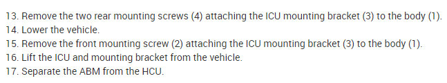

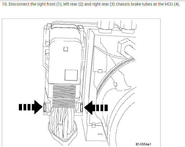

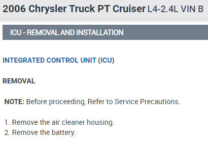

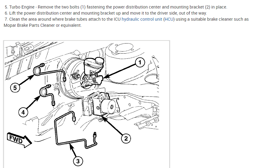

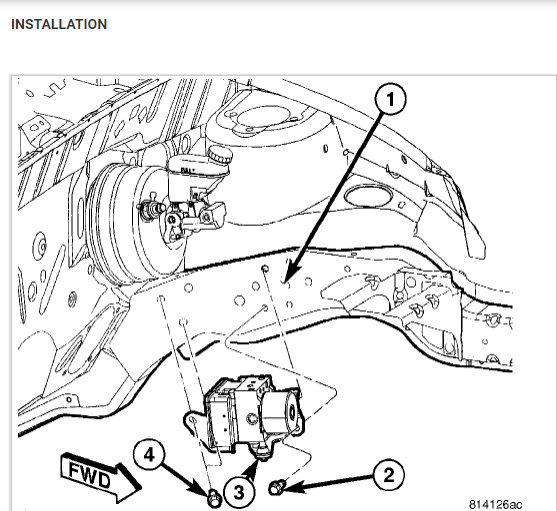

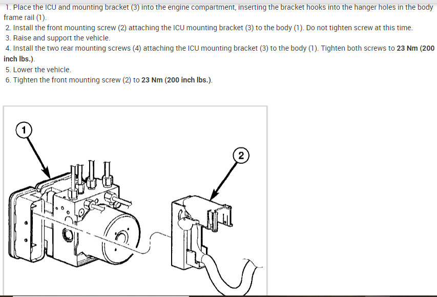

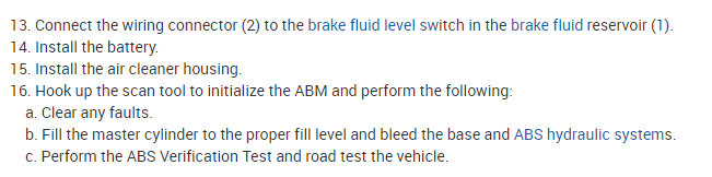

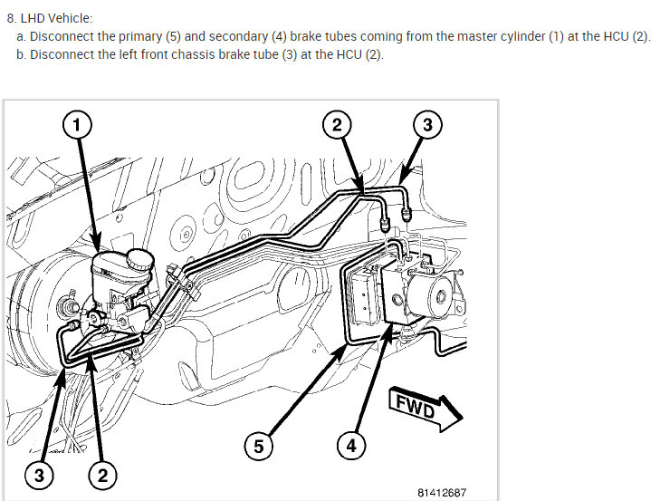

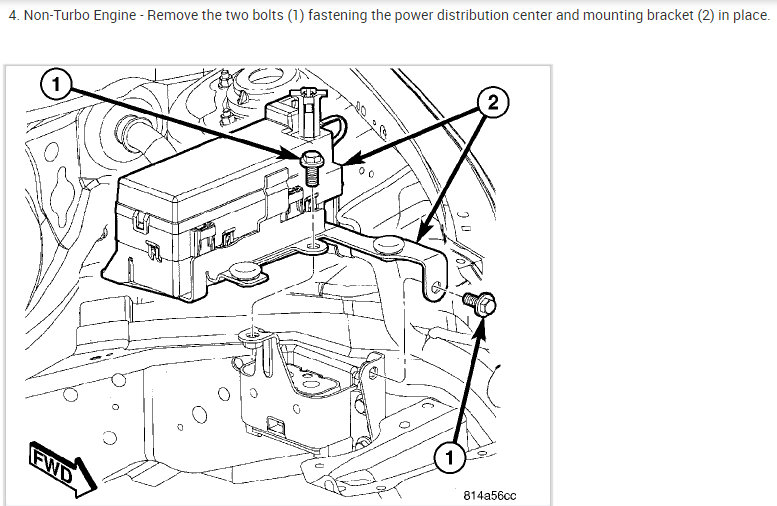

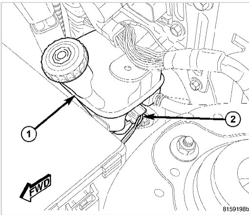

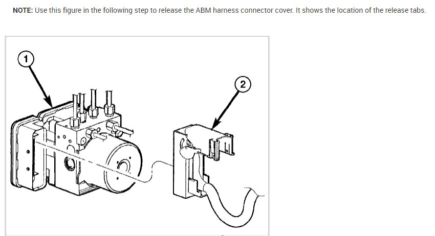

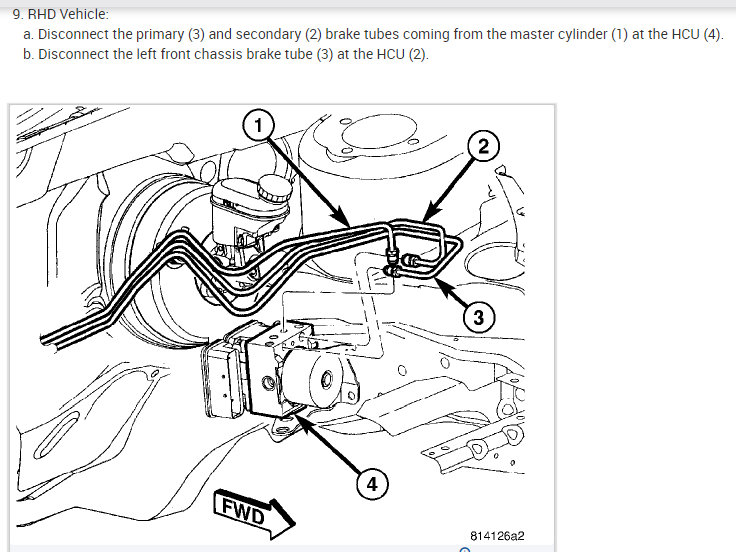

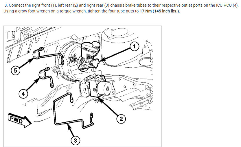

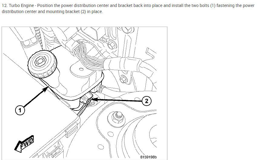

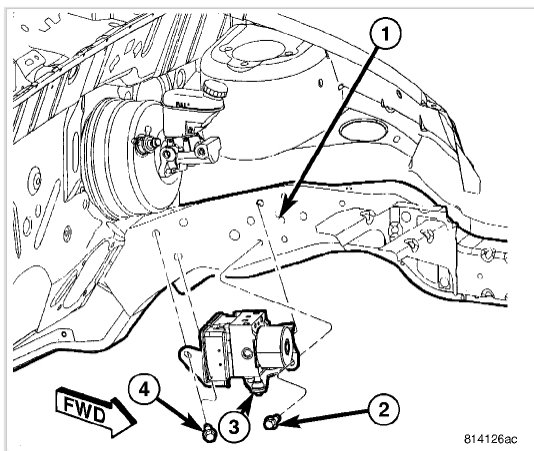

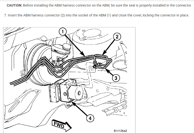

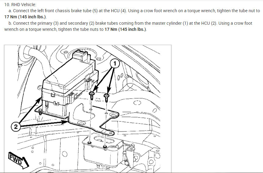

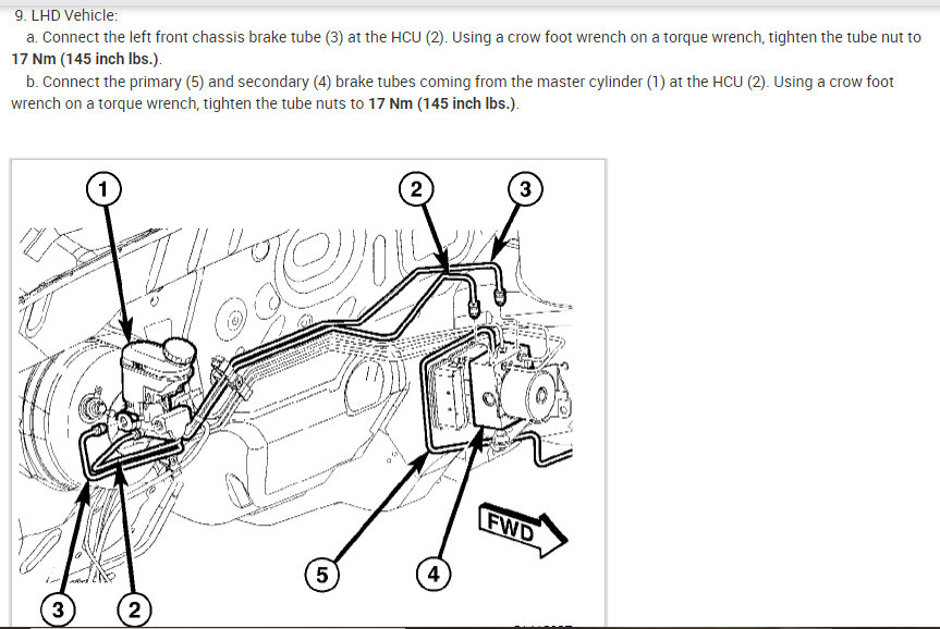

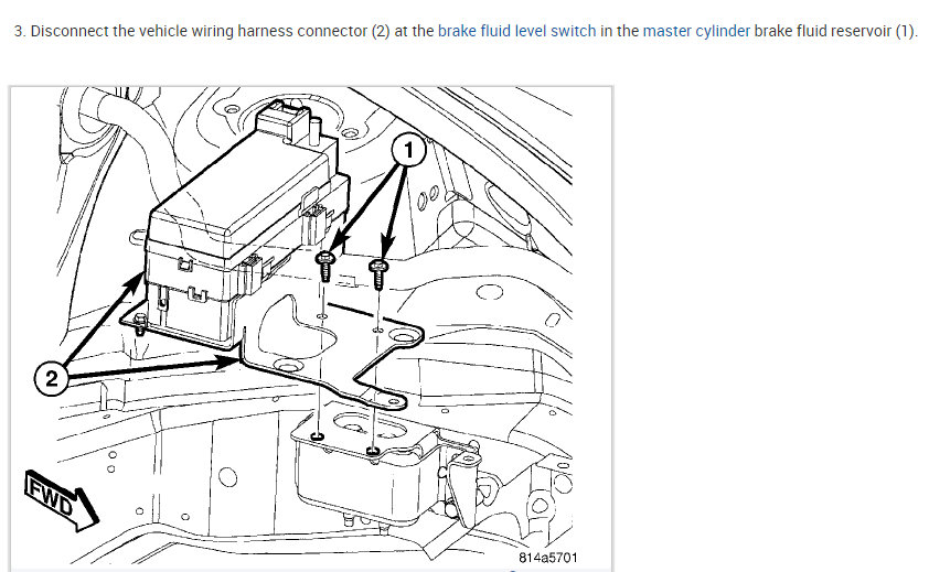

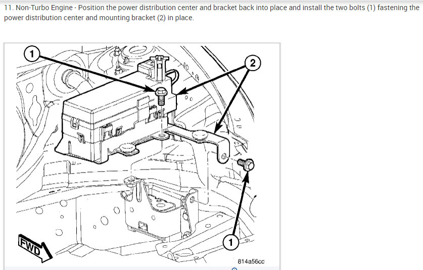

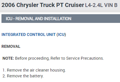

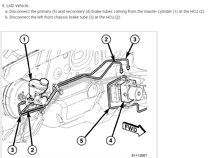

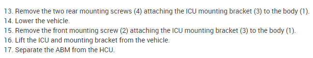

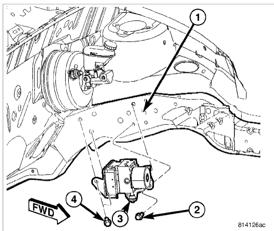

When changing brake pads I noticed the ABS module leaking I need to replace it.
Nov 10, 2009 at 12:16 PM
DANNY L
  • 5,648 POSTS
Hello, I'm Danny.

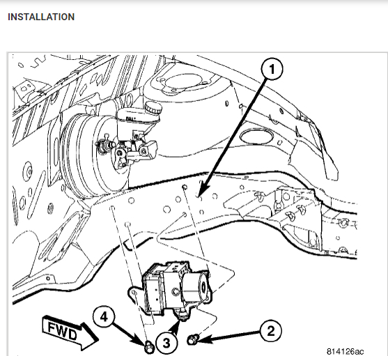

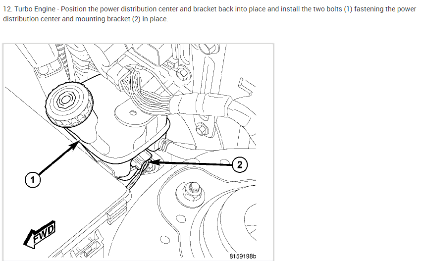

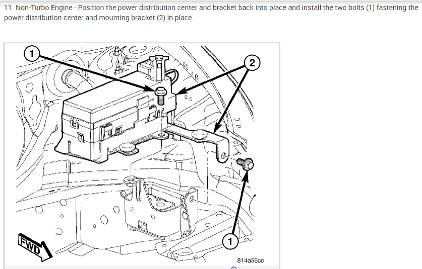

Here is the information you requested. I've attached picture steps below on how to replace the electronic brake module- hcu- hydraulic control unit on your car. Hope this helps and thanks for using 2CarPros.
