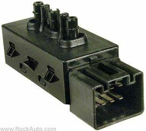

I just discovered that the drivers seat outside panel on my Cruiser was broken. When reading online forums this is an apparent problem. But I have a new one on order, so my only concern at this time is removing the power seat switch from the broken panel. Looking at the back of the panel shows that this switch just snaps in, but it has a large knob on the outside that must be removed to allow the switch to be removed. I am sure that these switches are expensive so I don't want to break the control knob off.
Any help is appreciated.

Jack O good evening, the problem that I am experiencing is that the large control knob on the outside of the seat trim does not allow removal of the switch. This switch snaps in place from the back side of the seat trim, no screws. I don't know if this knob attached via a barb type of attachment or there is some other type of mechanism holding it in place. If I am able to remove the knob from the front of the seat trim, the switch may be easily removed from the back side of the seat trim.

https://www.2carpros.com/forum/automotive_pictures/99387_7830a_thumbnail_6.jpg
are we talking about the same switch and if so the should knob pop out
+3
Thursday, May 13th, 2010 AT 8:09 PM
HILLCHARGER5
Jack O, good morning, your photo looks exactly like the problem switch. I will carefully try to pop the knob off.
Thanks a lot for the support.
+2
Friday, May 14th, 2010 AT 6:57 AM
HILLCHARGER5
Jack O, info worked perfectly!
