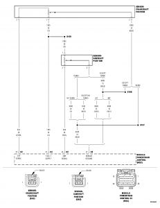

I scanned the car and got a P0340 error.
I changed the Camshaft Position Sensor and now I get P0344. I have had the error codes reset with an OBDII and get 0 errors returned but as soon as i start the vehicle I get the P0344 error back and the car goes into limp mode. I even put the old sensor back on, with the same results. Thanks for you help!

Possible Causes (F855) 5-VOLT SUPPLY CIRCUIT OPEN (F855) 5-VOLT SUPPLY CIRCUIT SHORTED TO GROUND (K44) CMP SIGNAL CIRCUIT SHORTED TO BATTERY VOLTAGE (K44) CMP SIGNAL CIRCUIT OPEN (K44) CMP SIGNAL CIRCUIT SHORTED TO GROUND (K44) CMP SIGNAL CIRCUIT SHORTED TO (F855) 5-VOLT SUPPLY TONE WHEEL/PULSE RING CAMSHAFT POSITION SENSOR PCM
https://images.2carpros.com/forum/automotive_pictures/99387_5239bl_16.jpg
