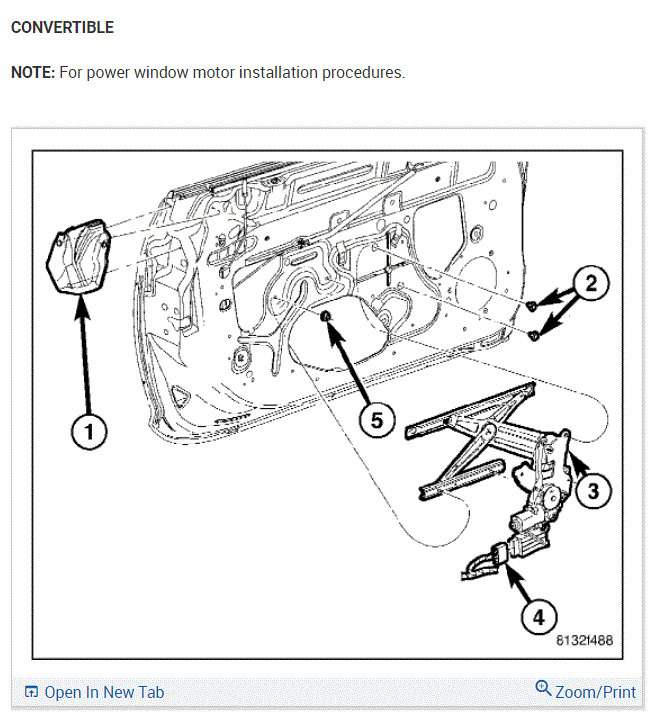

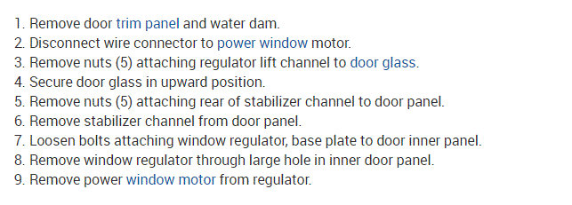

I heard the window make a thump as it fell into the door itself, right after I turned the car on. that window is rarely used. I tried to lift the glass but it appears to be jammed in the door. I can still hear the motor part of the window when I hit the switch to raise the glass but nothing moves. I need to replace the regulator
Jan 30, 2009 at 6:47 AM
  • 110,244 POSTS

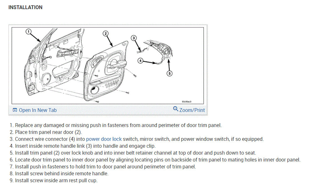

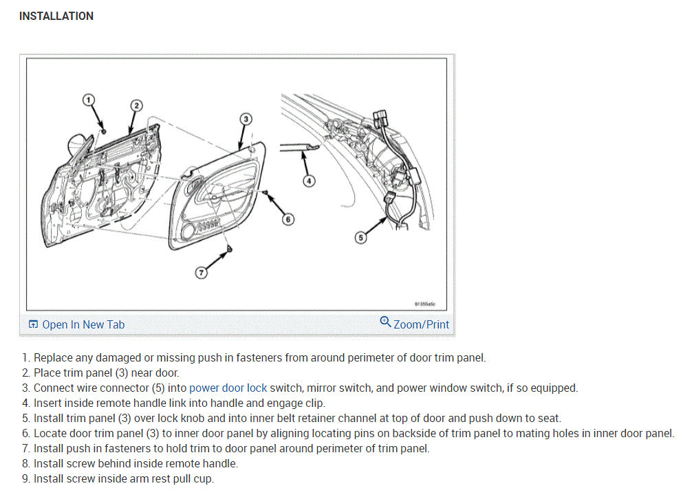

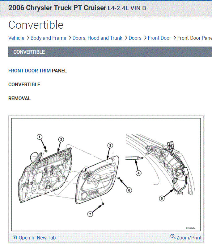

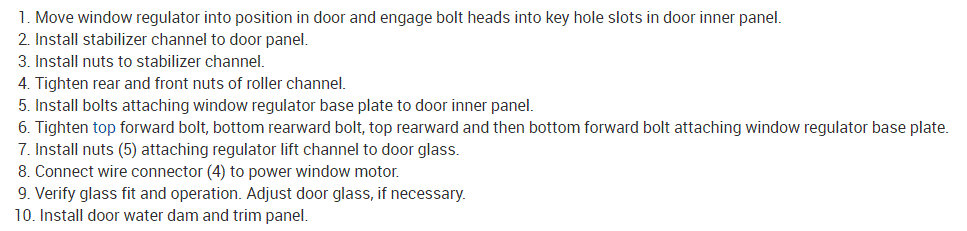

As far as replacing the regulator, it isn't too bad of a job. However, it can get frustrating. LOL

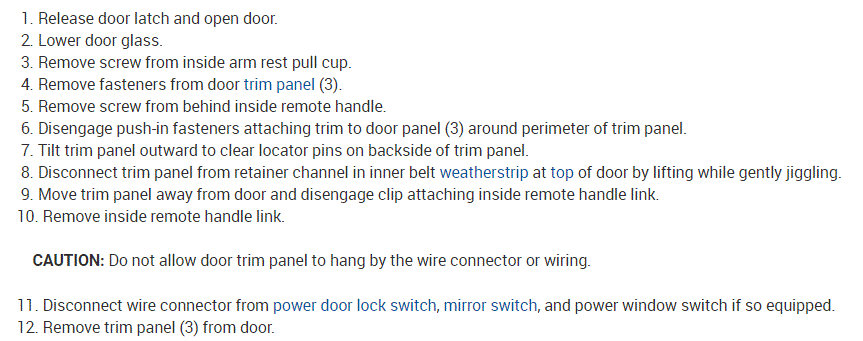

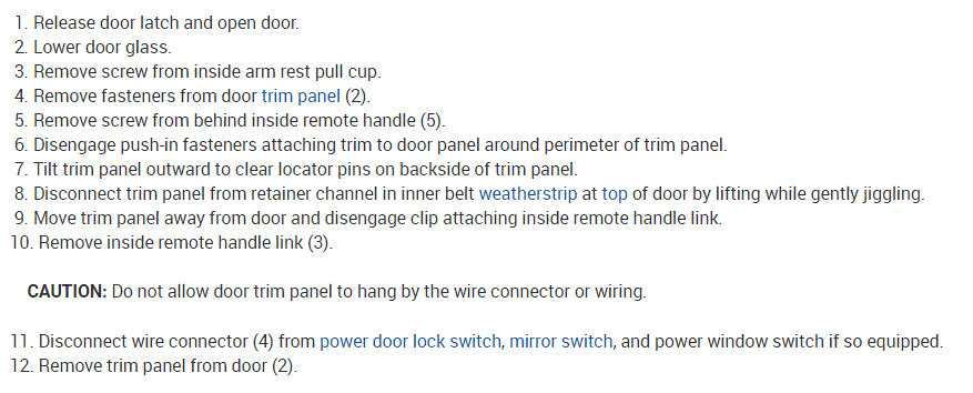

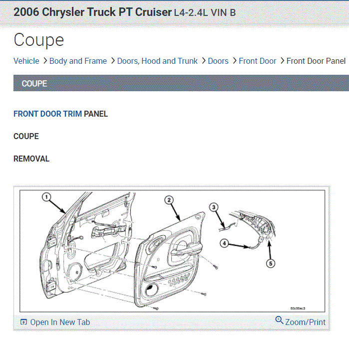

If you look below at the attached pics, I included the directions for both a coupe and convertible model. I'm not sure which you have. Additionally, the directions for removal of the door trim panel are included for both.
