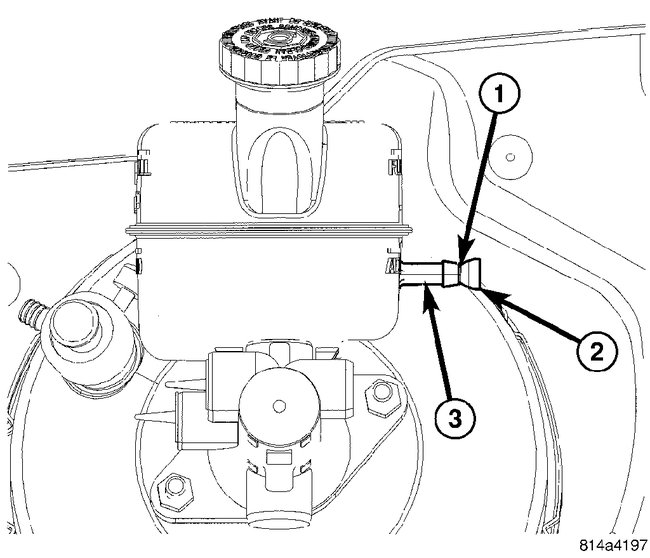

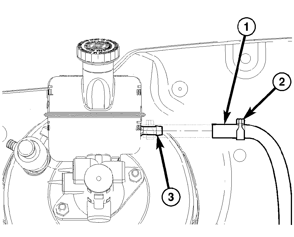

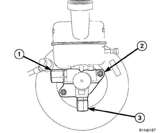

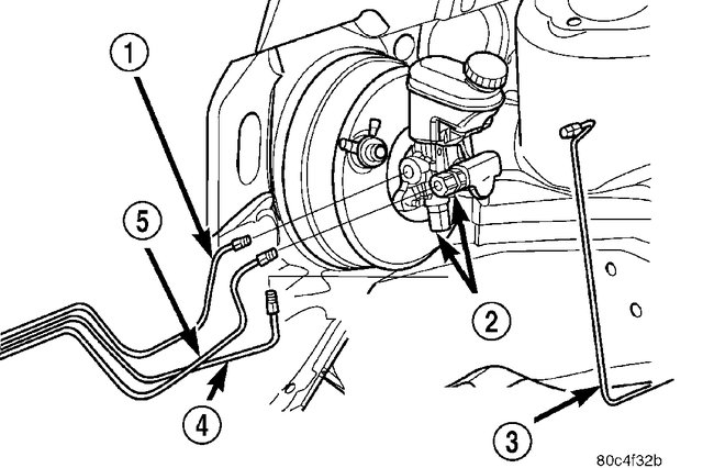

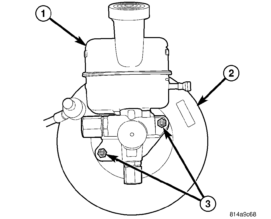

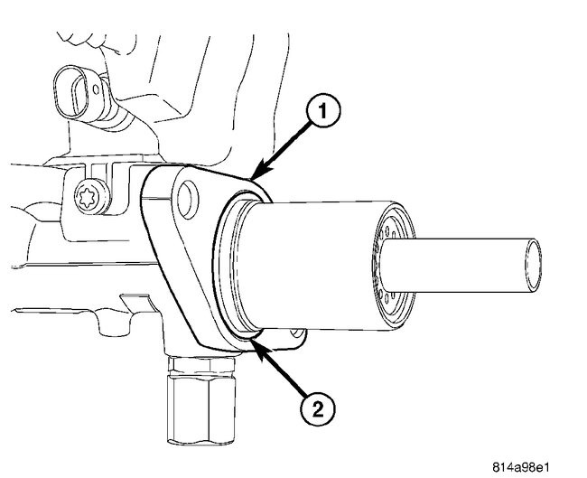

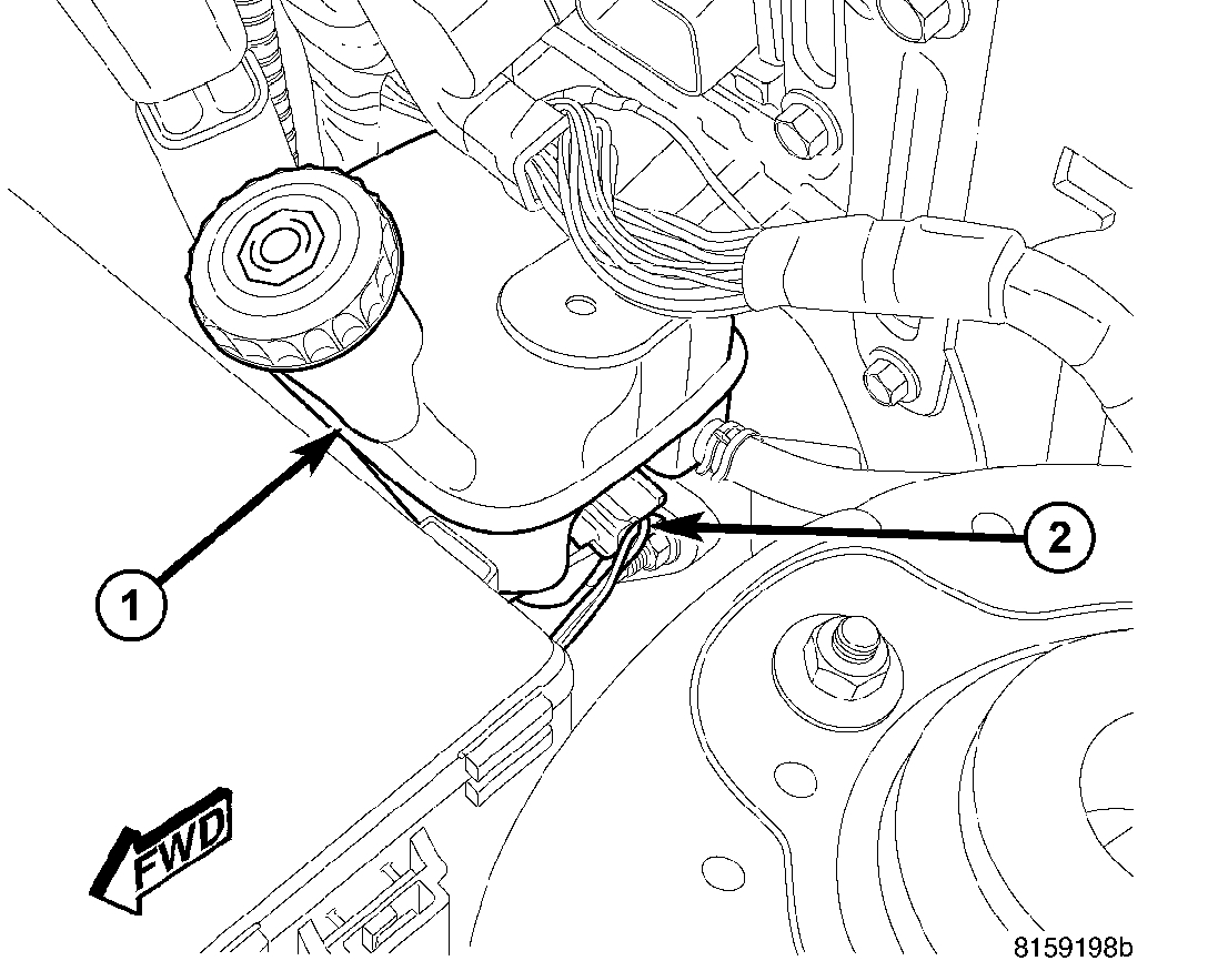

Opened hood I seen the brake master is leaking so you help me change it out?

pic 1
6. Remove the vehicle wiring harness connector (2) from brake fluid level switch in master cylinder brake fluid reservoir (1).
pic 2

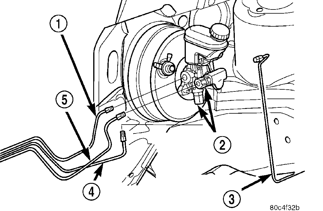

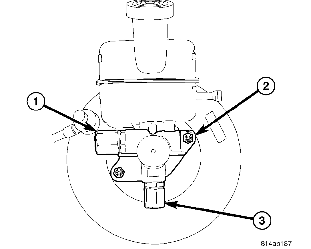

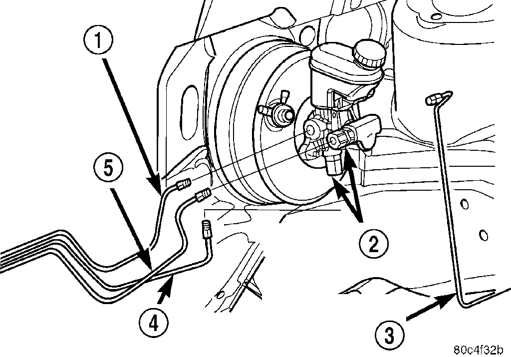

7. Disconnect the two front brake tubes (1, 3) from the master cylinder, and the two rear brake tubes (4, 5) from the proportioning valves (2). Install plugs at all of the open brake tube outlets on the master cylinder.
pic 3

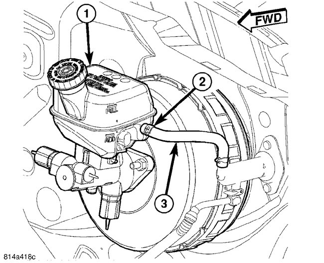

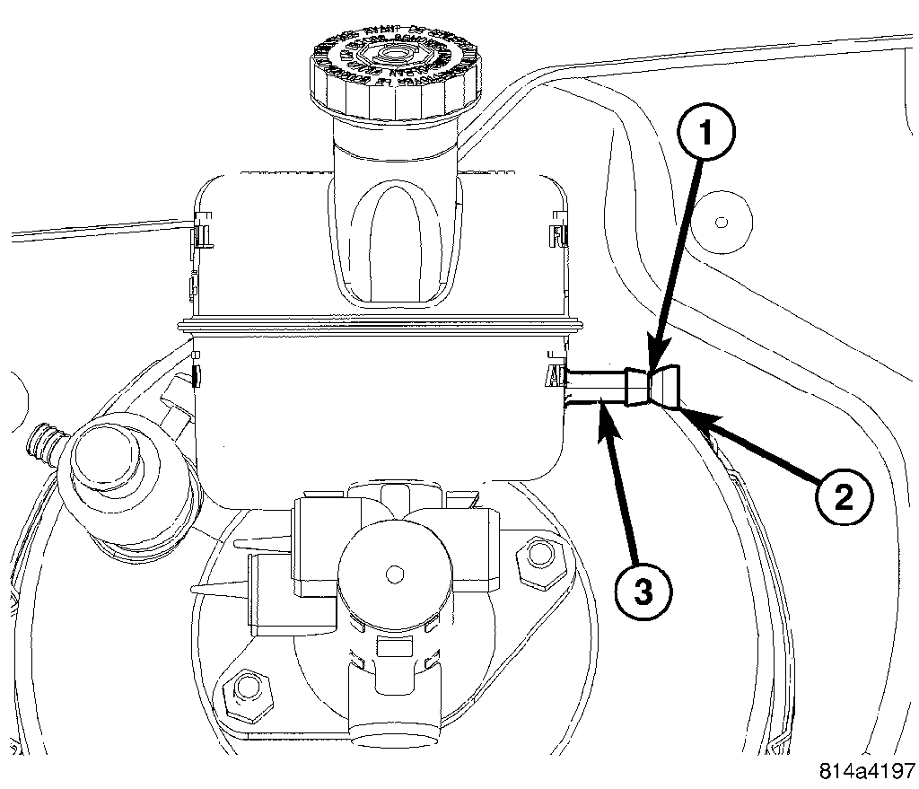

8. If equipped with a manual transaxle, remove the hose clamp (2) and slide the clutch actuator hose (3) off the reservoir port.
9. Clean the area around where the master cylinder attaches to the power brake booster using a suitable brake cleaner such as Mopar Brake Parts Cleaner or equivalent.
pic 4

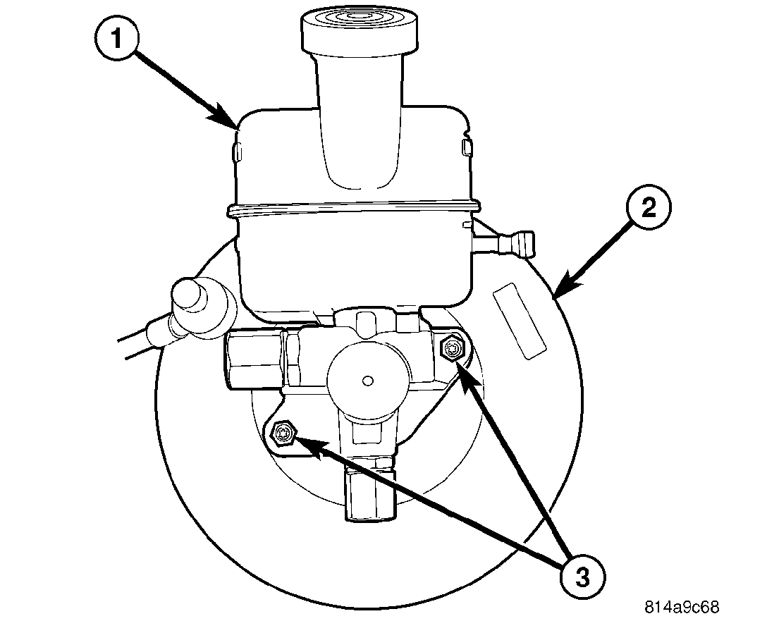

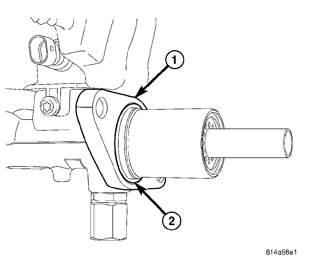

10. Remove the two nuts (3) attaching the master cylinder (1) to the power brake booster (2).
11. Slide the master cylinder straight out of the power brake booster.
pic 5

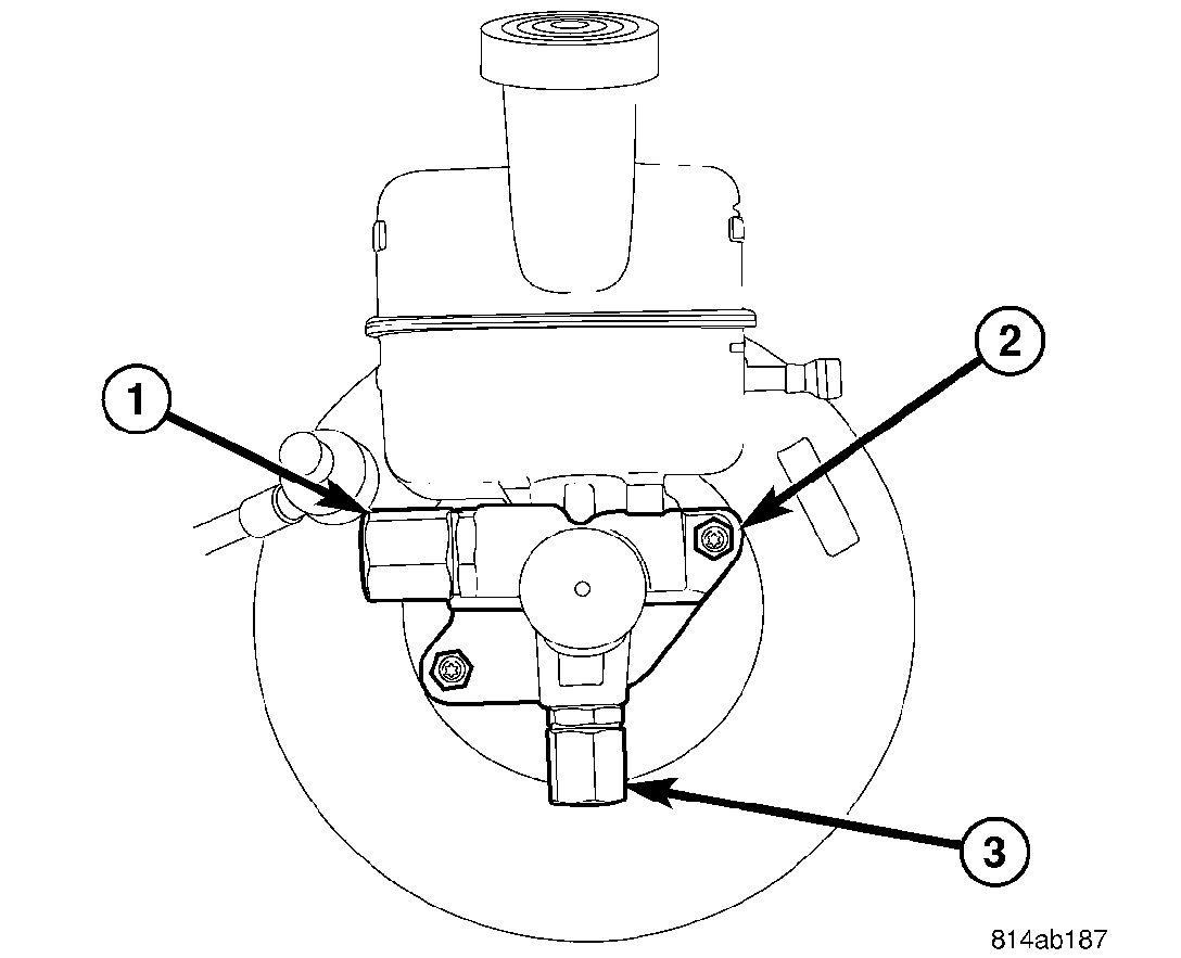

12. To remove the proportioning valves (1, 3), thread each from the master cylinder (2).

pic 6
1. If removed, install the proportioning valves (1, 3) in their master cylinder ports. The valves are identical, so they can be installed in either master cylinder port going to the rear brakes. Make sure the O-rings on the proportioning valves are new. Tighten the proportioning valves to 27 Nm (20 ft. lbs.).
NOTE: The master cylinder must be bled before installing it on the vehicle.
2. Bench bleed the master cylinder.
3. Wipe the face of the power brake booster clean where the master cylinder seal comes in contact when it's installed. Do not get any cleaner or debris inside the booster.
pic 7
CAUTION: When installing a master cylinder on the vehicle, a NEW vacuum seal (2) MUST be installed on the master cylinder mounting flange (1).
4. If the master cylinder does not have a NEW vacuum seal (2) installed on the mounting flange (1), remove it. Install a NEW vacuum seal on the master cylinder mounting flange making sure the seal fits squarely in its groove.
CAUTION: If resistance is met during master cylinder insertion into power brake booster, the master cylinder push rod may not be lined up with the booster push rod. Remove the master cylinder, realign and insert it again.
5. Line the master cylinder mounting holes up with the mounting studs on the power brake booster. Ensure the master cylinder piston push rod lines up with the booster push rod, then carefully slide the master cylinder into the power brake booster until it contacts the face of the booster.

7. If equipped with a manual transaxle and a NEW reservoir is being installed, using an appropriate cutting tool, cut the clutch actuator port (3) at the center of the "V" groove (1) opening the port. Discard the severed plug (2).
pic 10

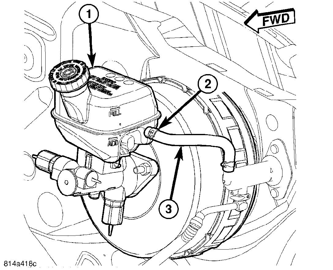

8. If equipped with a manual transaxle, slide the clutch actuator hose (1) onto the reservoir port. Install the hose clamp (2) just past the upset bead (3) on the port.

9. Connect the four brake tubes (1, 3, 4, 5) to the master cylinder ports and proportioning valves (2). Tighten the tube nuts to a torque of 17 Nm (145 inch lbs.).
^ Right front brake tube (1)
^ Left front brake tube (3)
^ Left rear brake tube (4)
^ Right rear brake tube (5)
