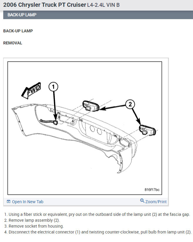

How do you replace back up lights bulbs on the PT
May 11, 2009 at 4:46 AM
SQM
  • 6,383 POSTS

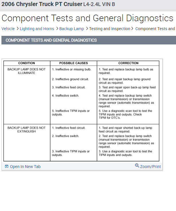

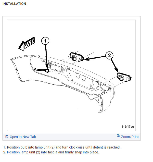

Replacing the backup lamp can be done easily.
The light assembly need to be removed from the car in order to access the backup lamp. The light housing will pop out when you pry it with appropriate pry tool which wont damage the paint.

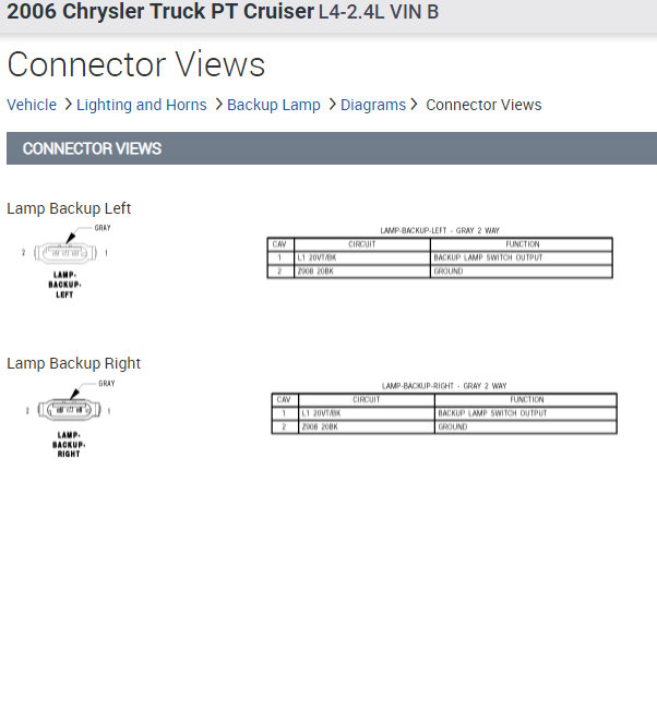

I have attached the replacement instructions as well as diagnostics for the backup lamps.
