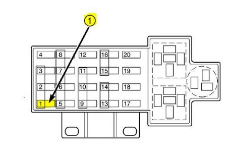

My windshield washer isn't working and I can find no fuse for it. Where would it be? The wipers work fine.

If wipers operates when washer fluid don't assume fuse and switch ok check and suspect W/W pump or wiring Pump is located at the lower end of the W/W tank Ask a helper to operate the switch as you check the motor If motor operates check for a pinch hose or a clogged nozzle
https://images.2carpros.com/forum/automotive_pictures/99387_Capture1_2.jpg

Where is that fuse box located? I know of two in the car. One in the lower dash area and one behind of the air cleaner.

Lower left side of dash Use a test light and test all the fuses best and sure way to eliminate a bad fuse
