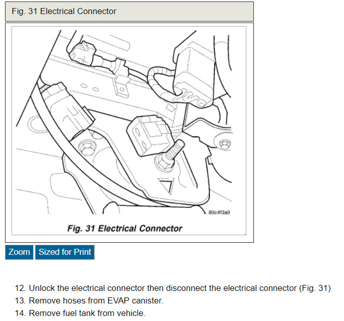

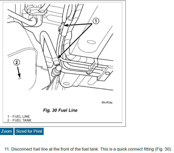

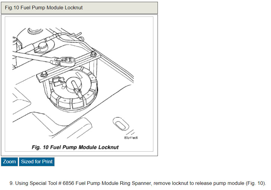

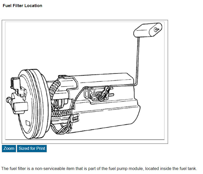

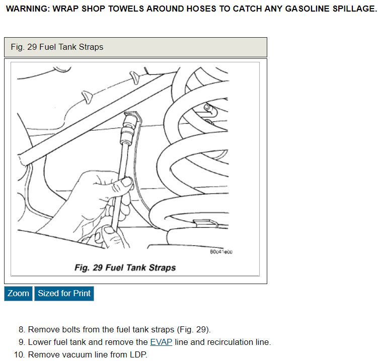

The fuel filter, is not serviceable, shows to be part of the fuel pump module. Here is a guide to help
https://www.2carpros.com/articles/how-to-change-a-fuel-filter

The fuel filter is part of the fuel pump to replace it you must drop the tank and remove the fuel pump here is a guide to help you see what you are in for when doing the job.
https://www.2carpros.com/articles/how-to-replace-an-electric-fuel-pump

The fuel filter mounts inside the fuel pump module. Is non serviceable part. Have to replace the fuel pump module, according to my info.

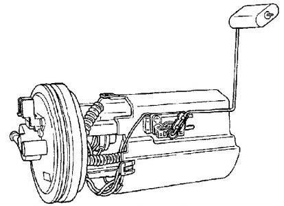

You don't change it as maintainence. It is part of the fuel pump module. Very pricy and very questionable when it comes to design.
https://images.2carpros.com/forum/automotive_pictures/30961_afupu_1.jpg
It is located in the fuel tank.
