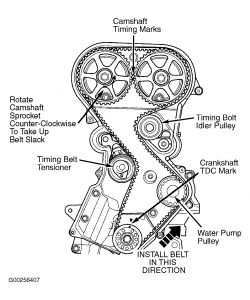

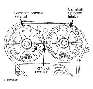

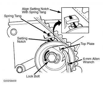

not sure where to point the marks on the cams, and the crank, i've done plenty of engine work, just not in the new 4cyl chrysler department.

Will this work?
