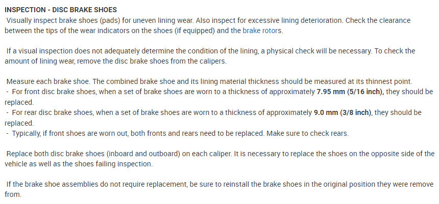

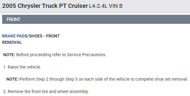

The brake light comes on when the car is in motion (5milesp/h & above) & goes out the the car stops. There is a squeaking noise when the car goes over a dip or bump. Could it be the brake pads are worn, I need to change the brakes.
Dec 2, 2008 at 4:07 PM
DANNY L
  • 5,648 POSTS
Hello, I'm Danny.

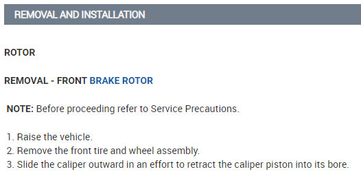

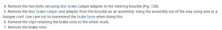

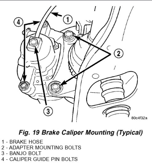

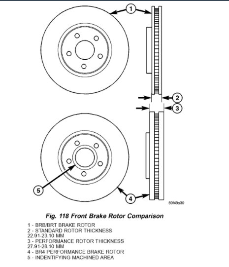

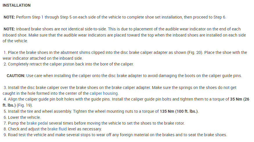

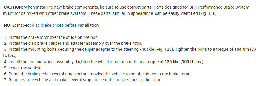

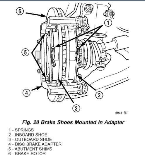

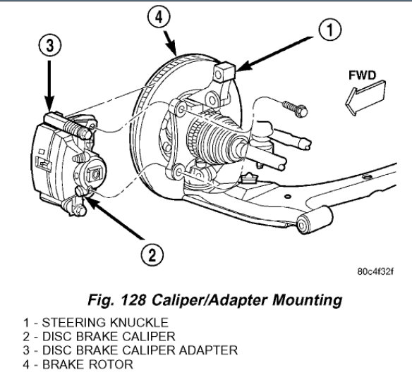

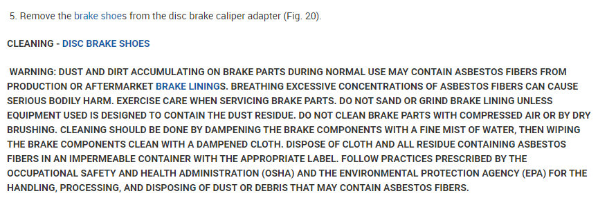

Here is the information you requested. Here is a tutorial showing how to remove and replace brake pads and rotors:
I've attached picture steps below on how to replace the front pads and rotors on your car. Hope this helps and thanks for using 2CarPros.
