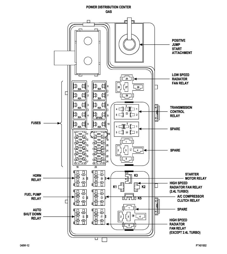

i recently diagnosed my pt as having a bad fuel pump checked fuses and relays swapped the relays and removed the fuel pressure line and cranked the motor nothing. so i replaced the fuel pump and rehooked every thing back up and still no fuel rechecked all fuse and re swapped relays .when i get home from work i am gonna check for power at the pump but I am pretty sure thats going to be fine . does anyone know if there is a switch or sensor that could cause the fuel pump not to turn on. like a bad coolant temp or faulty cam or crank sensor

Check the Auto Shutdown relay if it is not closing pump will get no power via pump relay
See the guide below on relay testing
Heres the ASD relay location
