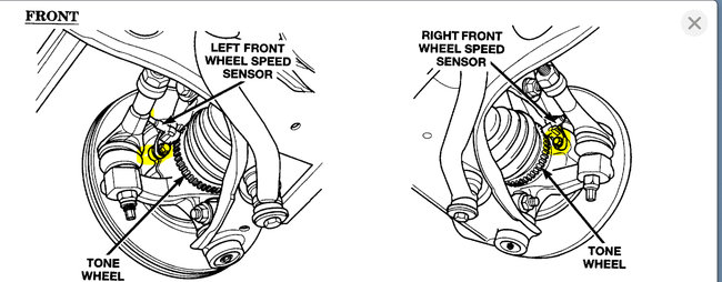

thank you for taking my questions. Need to know how to replace front wheel speed sensor.
Jul 16, 2009 at 7:52 AM
  • 110,194 POSTS
Replacing a wheel speed sensor isn't a difficult job. On some vehicles, the sensor is used for the ABS system, stability control, speedometer, and even traction control.
As far as replacement, here is a link that explains in general how it is done. You can use this as a guide.
https://www.2carpros.com/articles/how-to-replace-an-abs-wheel-speed-sensor
Here are the directions specific to your vehicle. The attached pics correlate with the directions.
_____________________________
The wheel speed sensor is located on the rear of the wheel spindle and is held in place with one bolt.
See pic 1 for location (front).
Remove the bolt and gently remove the sensor from the housing. Next, follow the wiring from the sensor to a connector.
Disconnect the old sensor.
Install is the reverse of removal.
