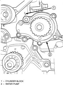

Did what you said. Found out thermostat was bad because water pump broken. Antifreeze also leaking out of car. Put on new thermostat. Getting ready to change water pump, will change timing chain or belt at the same time. Just need a few pointers on how to chang a water pump. I think I basically know how but could use a few step by steps. I really appreciate you hangin in there with me these few days with all the helpful info you've been giving. Thanks.

Here is the removal and installation of the water pump.
Remove or disconnect the following:
Negative battery cable
Timing belt
Camshaft sprockets
Rear timing belt cover
Water pump and discard the O-ring
http://www.2carpros.com/forum/automotive_pictures/46384_water_pump_2.jpg
Installation
Apply dielectric grease to the new O-ring before installation
Before proceeding, be sure the O-ring gasket is properly seated in the water pump groove before tightening the screws. An improperly installed O-ring could cause a coolant leak.
New O-ring in the water pump groove
Water pump and torque the bolts to 105 inch lbs. (12 Nm)
Rotate the pump by hand to check for freedom of movement.
Camshaft sprockets
Timing belt(good idea to change this while you're there)
Fill the cooling system.
Start the vehicle and check for leaks
