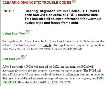

https://images.2carpros.com/forum/automotive_pictures/55316_03gtcruisermil_1.jpg
Replacing the coil would have been the fix that you need for the P0300. But the CEL has to be either physically reset via an OBD-II scan tool or 3 good trips without any problems seen by the PCM. I would suggest that you bring the vehicle to your local Autozone, and they can read and then erase/reset the computer. Please be sure though that you only receive P0300 from their scanner prior to erasing. If they find any other DTCs or codes, please report back with the code numbers.

Did you get the codes cleared properly so that we can see what comes back?
