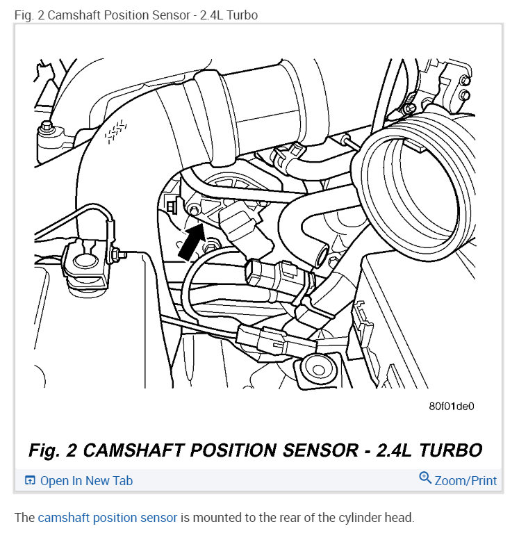

error code P0344
2003 CHRYSLER PT CRUISER
30,000 MILES • 4 CYL • 2WD • MANUAL
JOEPURETZ
  • 6 POSTS
What does this mean as far as performance?
Mar 6, 2008 at 6:23 AM
  • 75,992 POSTS

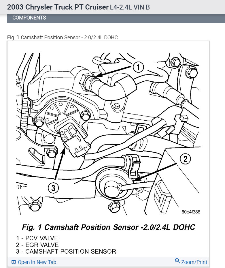

The code P0344 relates to the camshaft positioning sensor. I would replace it to see what happens. here is the location in the diagrams below. Check out the diagrams (below). Please let us know what you find. We are interested to see what it is.
