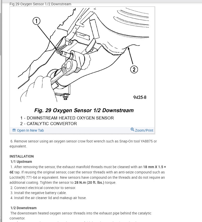

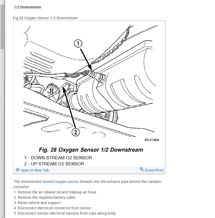

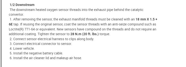

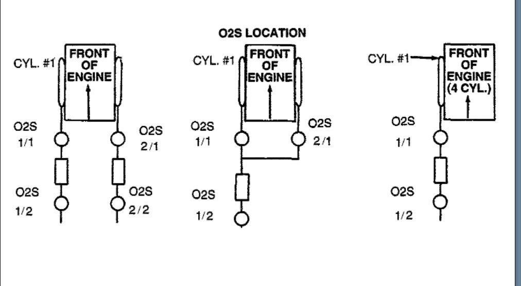

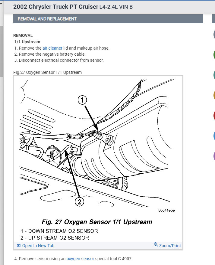

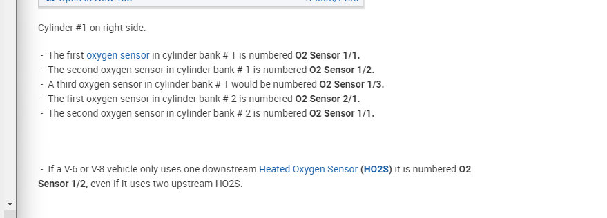

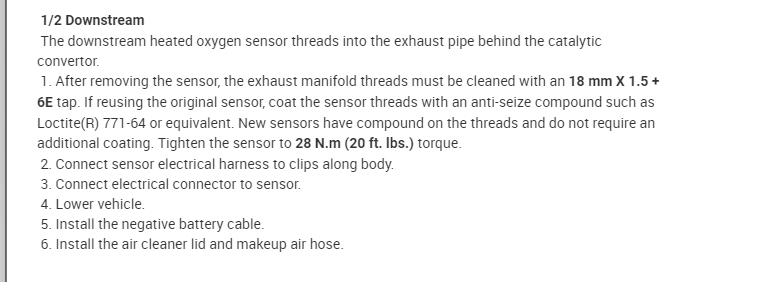

I have an 02 PT Cruiser that keeps throwing the check engine light. When I put my scan tool on it, it reads that the O2 sensor on bank 1 is not functioning right. My question is where are the O2 sensors located at on this car
May 30, 2008 at 11:05 AM
These sensors are located before and after the converter.
Here is a video that will help with this on a similar vehicle:
https://youtu.be/B4CAou7i7Io
Below you will find a diagram of the general locations of the sensors so please review this and the process to replace them.
Please let us know what questions you have. Thanks
