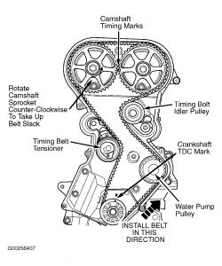

2002 Chrysler PT Cruiser lining up timing marks properly
2002 CHRYSLER PT CRUISER
78,000 MILES • 4 CYL • FWD • AUTOMATIC
ROBT W
I have the book on this vehicle and i have done everything by thr book and i cant seem to get this car to start any suggestions would be greatly appreciated

Did the original timing belt break or jump time?

Did T-Belt break while engine was running? if yes check compression engine interference type ie. valve bender
https://images.2carpros.com/forum/automotive_pictures/198357_Graphic_646.jpg

This isn't a true interference engine. The pistons clear the valves, however the valves can contact each other if the cams are rotated independently.
