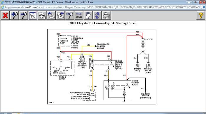

I have replaced battery battery cable and the starter. The car will not spin over with the key. Will not crank everything inside is working as should such as lights radio etc. I am a general mechanic I am looking for a Chrysler specialist.

Is the security light on solid or flashing?If not we need to follow this guide to see if the starter is okay. It sounds like the starter relay could be bad.

If the security light isnt on then you should have power to the yellow wire coming out of the ignition switch with the key in the start position. Also constant power to the red wire at the ignition switch.

SATURNTECH9
  • 30,869 POSTS
As long as the lights go out and stay out were good. Go ahaed and check those wires.
Friday, January 3rd, 2020 AT 10:01 AM (Merged)
HOWTODRIVESAFE
We checked the power wires your talking about I have no power to these wires.
SATURNTECH9
  • 30,869 POSTS
The red wire to the ignition goes back to the number 1 thirty amp fuse in the under hood fuse box like it shows in the wire diagram I posted. So see if there is power to both sides of that fuse.
HOWTODRIVESAFE
I was wrong red is hot yellow is not. I installed a new ignition switch that fixed it
