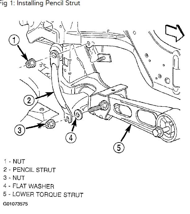

Remove lower torque strut.

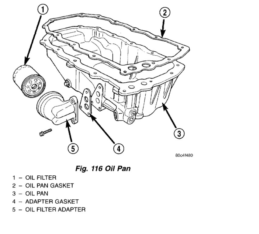

Remove oil filter adapter and gasket (Fig. 116).
Remove oil pan and gasket (Fig. 116).

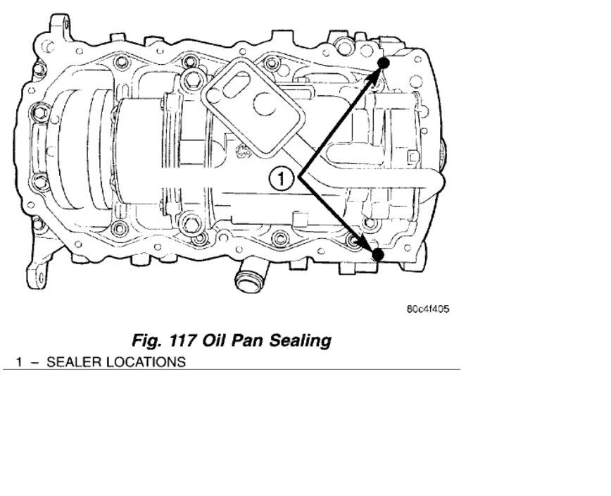

Apply Mopar RTV GEN II at the oil pump to engine block parting lines (Fig. 117).
Install oil pan gasket to the block.
Install pan gasket and pan. Tighten screws to 12 Nm (105 in. lbs.) .
Install oil filter adapter and gasket (Fig. 116). Tighten screws to 12 Nm (105 in. lbs.) .

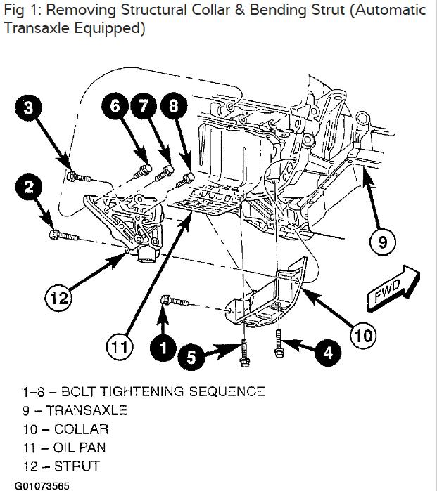

I'm trying to remove a oil pan and 3 of the bolts are under the structural collar and I need to remove and need to know how to remove the structural collar vie have tried a ratchet with a socket and a crechent wrench neither worked. How do I remove the structural collar

you have to remove collar with bolts indicated. you will have to support engine from top also you need to remove lower torque strut see pics.

can i use a jack to support the engine
Dec 22, 2016 at 7:55 AM (Merged)
HMAC300
  • 48,601 POSTS
nope, too dangerous especially pulling the pan, you need to support the engine from above.
JOSH24
  • 14 POSTS
so i have to use a cherry picker
HMAC300
  • 48,601 POSTS
or something strong enough to hold the engine. of course if engine mounts are not disconnected you are good to go.
