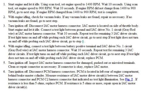

Hello, I did the code look up and the code said
The Idle Speed Control Motor doen't seem to be working properly
what do i need to do

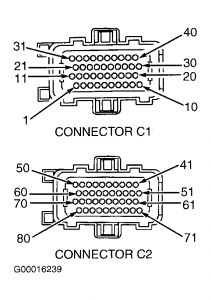

Hello I don't believe the previous fan repairs would have anything to do with this, unless the mechanic who serviced the vehicle accidentally unplugged or in some manner harmed the wiring of the IAC. You should test all of the wiring to the IAC motor. Perform the following procedures and post your results. I will follow up.
https://images.2carpros.com/forum/automotive_pictures/261618_Noname_15.jpg
FIGURE 2
https://images.2carpros.com/forum/automotive_pictures/261618_Graphic_14.jpg
