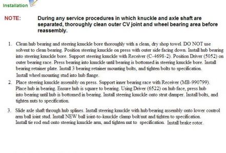

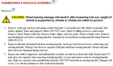

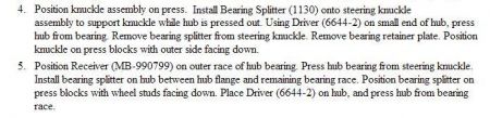

2001 Chrysler PT Cruiser CHANGING FRONT wheel brng
2001 CHRYSLER PT CRUISER
90,000 MILES • 4 CYL • FWD • AUTOMATIC
MIKE CLINE
having trouble removing the hub
Jul 10, 2009 at 7:06 AM
