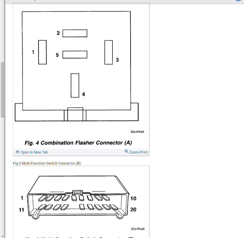

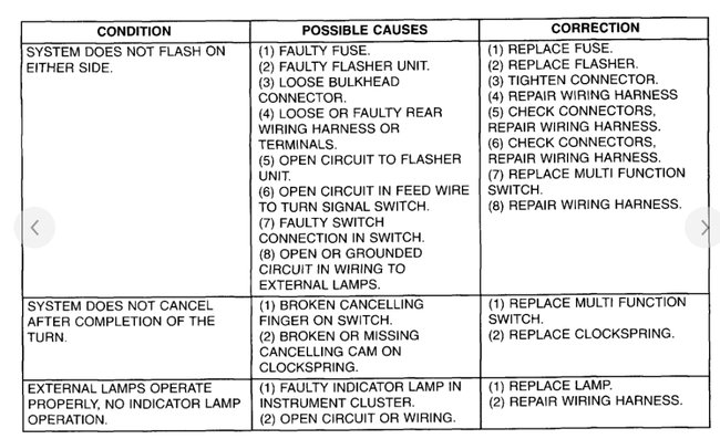

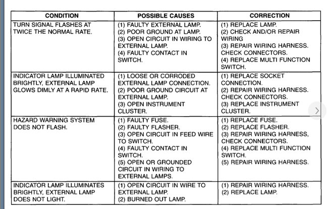

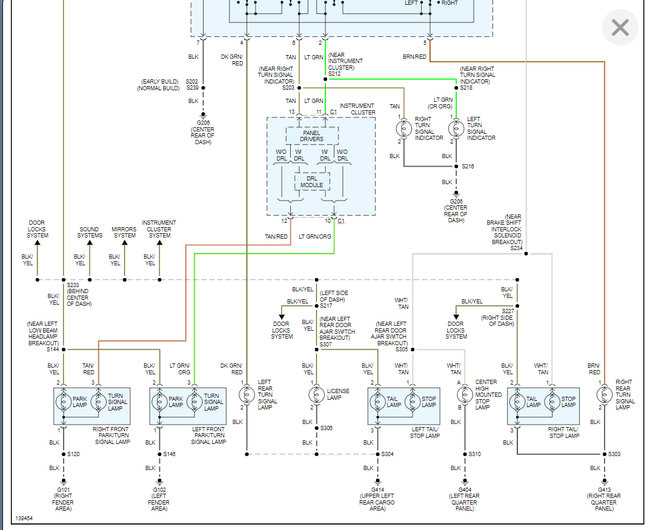

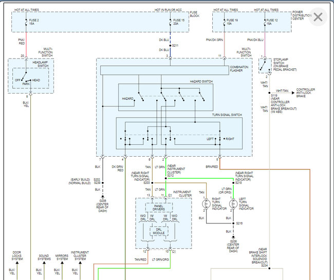

After spending $800 to fix the car last month, another problem pops up this month as if on cue.The directional signals and the emergency flashers just stopped working. About 3 - 4 months ago this happened intermittently, stopped happening about 2 - 3 weeks ago and then last night just stopped working. Other than blowing up the car, do you have any suggestions about how to approach this problem? I can't afford dealer prices for repairs anymore.
Oct 19, 2009 at 10:49 AM

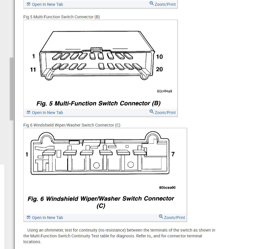

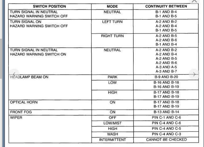

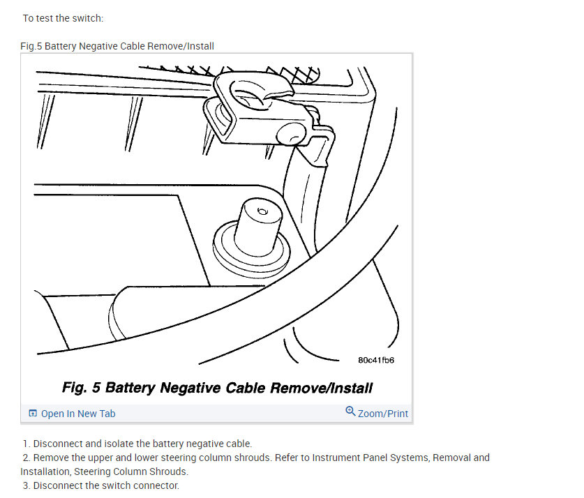

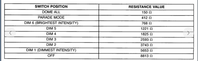

More than likely this is an issue in the multi function switch. However, the way to test this is to check the voltage coming out of the switch on each of the circuits that are not functioning.
Here is a guide that will help with this:
I attached the wiring diagram but also the process from the manual on how to test the switch below. Please run through this material and let us know what questions you have.
Thanks
