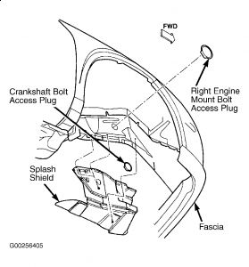

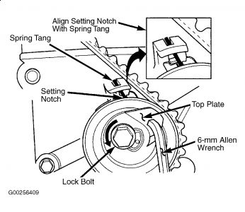

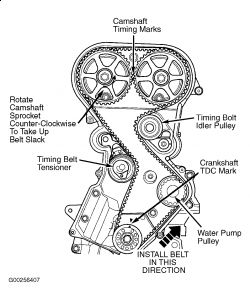

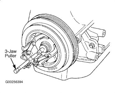

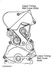

We need to replace the water pump and would like a diagram and/or instructions for this.

Its not a jump that I would recommend for you to do your self if not had the experience and knowledge with timing belt as the end result maybe bent valves it requires special puller this is some of the pictures needed
https://images.2carpros.com/forum/automotive_pictures/99387_Graphic1_287.jpg
https://images.2carpros.com/forum/automotive_pictures/99387_Graphic2_130.jpg
https://images.2carpros.com/forum/automotive_pictures/99387_Graphic3_63.jpg
https://images.2carpros.com/forum/automotive_pictures/99387_Graphic5_19.jpg
https://images.2carpros.com/forum/automotive_pictures/99387_Graphic6_13.jpg
