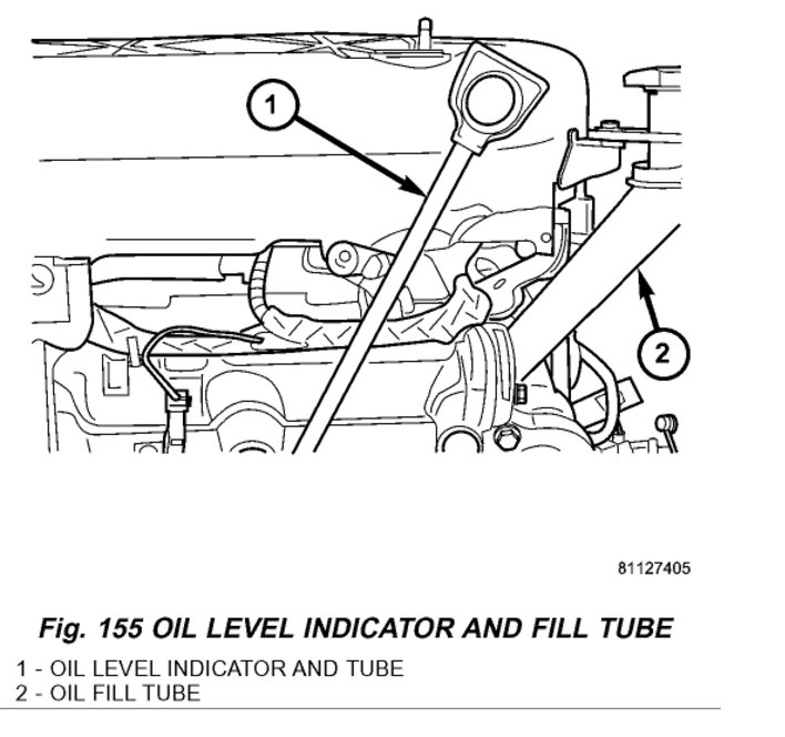

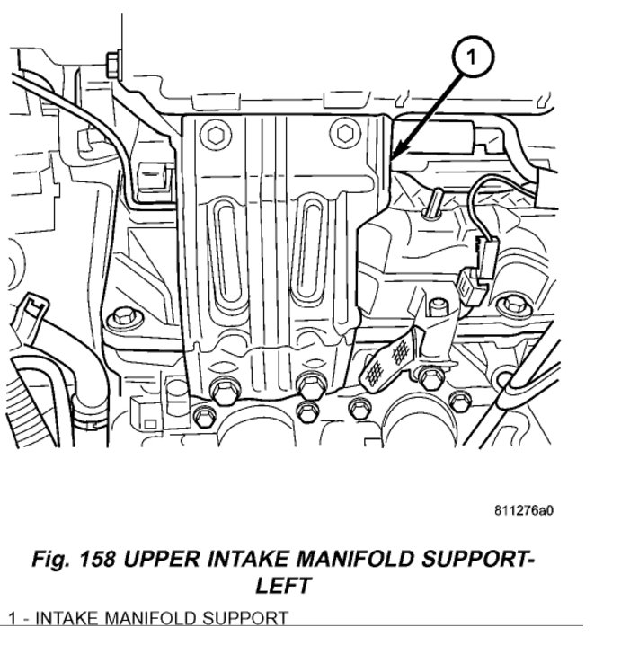

There is a coolant pipe that runs under the intake manifold which is seals by an O ring. The intake must be removed to replace the seal. Here is a guide that will give you an idea on what you are in for and some diagrams to help you get the job done.
https://www.2carpros.com/articles/replace-intake-manifold-gasket
and
https://www.2carpros.com/articles/car-is-leaking-coolant
Please let us know what happens so it will help others.
