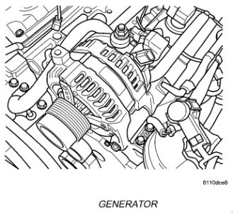

I need to know the easiest way to change the alternator and is there any special tool I need?
Oct 1, 2010 at 3:52 PM
  • 75,992 POSTS

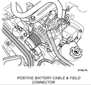

There is no easiest way but the right way to do it-see procedures below: REMOVAL Disconnect battery negative cable. Remove the engine cover. Remove the generator drive belt. Positive Battery Cable And Field Connector
https://images.2carpros.com/forum/automotive_pictures/12900_a1_22.jpg
Remove the B+ terminal nut and wire. Disconnect the generator field circuit wiring connector. Push the RED locking tab to release. Upper Mounting Bracket

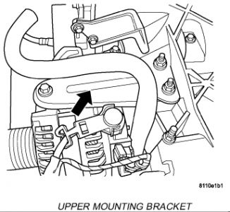

Remove the upper mounting bracket. Generator
https://images.2carpros.com/forum/automotive_pictures/12900_a3_2.jpg
Remove the 2 lower mounting bolts. Remove generator. INSTALLATION Install generator. Generator
Install the 2 lower mounting bolts. Upper Mounting Bracket
https://images.2carpros.com/forum/automotive_pictures/12900_a2_22.jpg
Install the upper mounting bracket. Tighten the 2 lower bolts first, tighten bolts to 54.2 N.m (40 ft. lbs.) then tighten the 2 upper bolts, tighten bolts to 28.2 N.m (20.8 ft. lbs.) . Positive Battery Cable And Field Connector
Connect the generator field circuit wiring connector. Push the RED locking tab to lock connector. Install the B+ terminal nut and wire making sure the terminal is properly oriented with the anti-rotation tab. Tighten nut to 12.5 N.m (110 in. lbs.) . Install the generator drive belt. Install the engine cover. Connect battery negative cable. https://www.2carpros.com/kpages/auto_repair_manuals_alldata.htm
