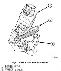

how to change air filter?

ELEMENT-AIR CLEANER REMOVAL 1) Disconnect the intake air temperature sensor (IAT) wiring harness connector. 2) Disconnect the air inlet tube at the throttle body 3) Remove the cover screws 4) Lift cover and pull toward the engine and remove cover tabs from air box.

5) Lift cover and remove the element (Fig. 16). INSTALLATION 1) Install the air filter element into air box (Fig. 16). 2) Move cover so that the tabs insert into the air box. 3) Seat cover onto element housing and tighten the screws. 4) Reconnect the air inlet tube and tighten clamp. 5) Connect the intake air temperature sensor wire harness connector
