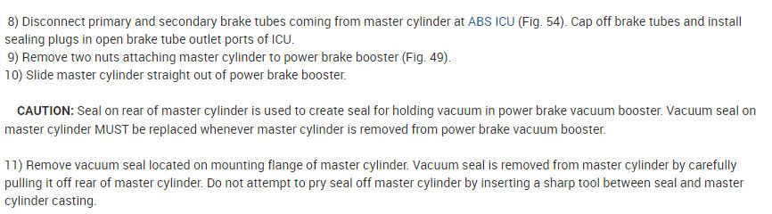

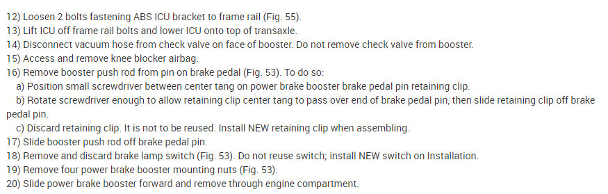

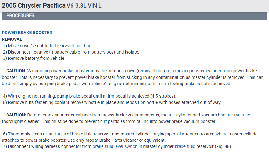

I need help with replacing the brake booster I have codes.
Jun 6, 2009 at 8:34 PM
DANNY L
  • 5,648 POSTS
Hello, I'm Danny.

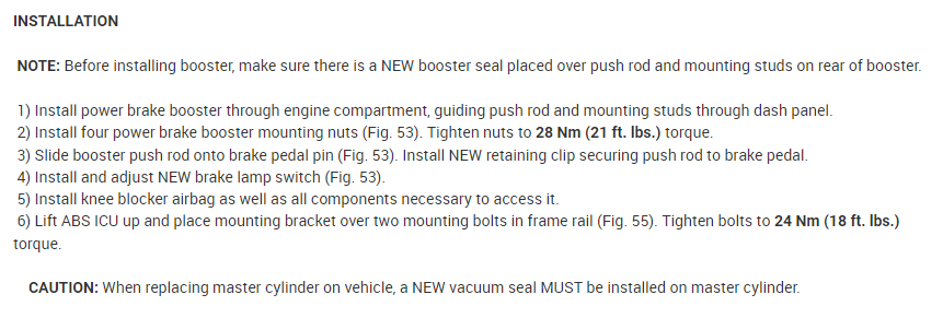

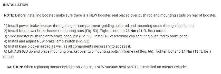

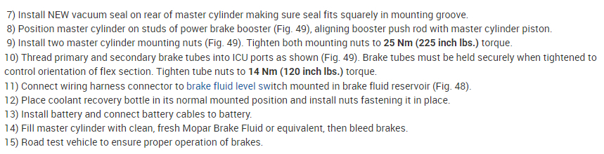

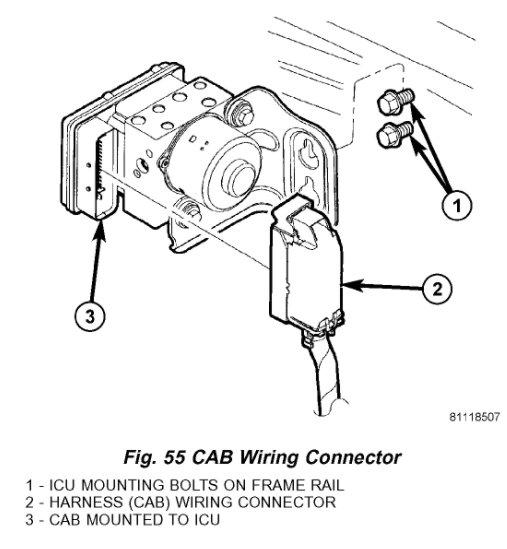

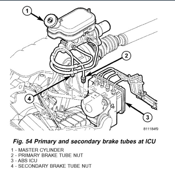

Here is the information you requested. Be sure to just move the brake master cylinder slightly out of the way so that you don't have to open a line and then have to bleed the brake system. I've attached picture steps below on how to change the power brake booster on your vehicle. Hope this helps and thanks for using 2CarPros.
