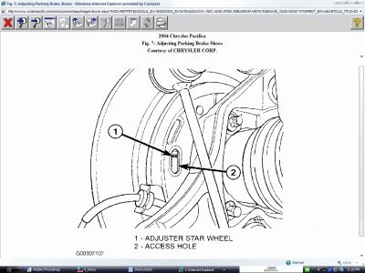

Anybody know how to adjust the Emergency Brake ??Thanks

Look for the access hole on the back side of the backing plate. Adjust with a drum brake spoon, or screwdriver. Then turn the adjuster to until you hear it just barely contact the rotor. Check out the diagrams (Below). Please let us know if you need anything else to get the problem fixed.
https://images.2carpros.com/forum/automotive_pictures/62217_Adjust_2.jpg
