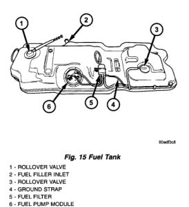

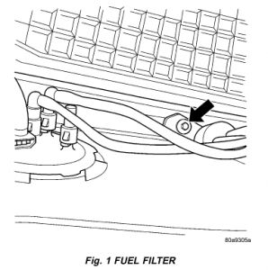

i have a chrysler voyager and I am unable to locate the fuel filter, thanks in advance for assistance.

Fuel Filter Location
Fig. 1 Fuel Filter
Fig. 15 Fuel Tank
The fuel filter is located on the fuel tank next to the fuel pump module.
