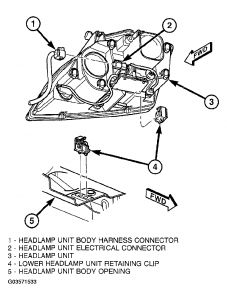

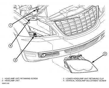

How do I change the change the low beam blub in a 2004 chrylser pacifica, I took out the two small screws at the top holding the assembly in but it still won't come out where I can get to it. That was all my manual said to do and pull forward.

Hello .. thanks for the donation .. much appreciated Hope this helps REMOVAL Open hood, disconnect and isolate the battery negative cable. Remove the two headlamp unit retaining screws (Fig. 23 ). Gently pull headlamp unit forward, unsnapping it from the lower retaining clip (Fig. 24 ). Be careful not to damage lower retaining clip upon removal. Disconnect the headlamp unit electrical connector (Fig. 24 ). Transfer the lamps to the new headlamp unit if replacing. INSTALLATION Transfer the lamps to the new headlamp unit if replacing. Connect the headlamp unit electrical connector (Fig. 24 ). Gently place the headlamp unit into the body opening. Make sure the lower retaining clip is placed on the retaining bar on the bottom of the headlamp unit (Fig. 24 ). Be careful not to damage lower retaining clip upon installation. Install the two headlamp unit retaining screws (Fig. 23 ). Connect the battery negative cable. Verify vehicle and system operation. Close hood. Fig. 23: Identifying Components Of Headlamp Unit Mounting
https://images.2carpros.com/forum/automotive_pictures/266999_head_5.jpg
Fig. 24: Identifying Components Of Headlamp Unit Lower Attachment
https://images.2carpros.com/forum/automotive_pictures/266999_head2_3.jpg
