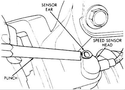

Ok I took it to a shop today and to make it short, the wheel bearings are bad. I thought there were ok, but after inspection, and feeling the red hot hub.....yeah. So any help on dissasembly, I have all the bolts loose, is the wheel flange pressed on? I have access to a puller if so, or do i just need to spray it with penetrant and coax it with a hammer and torch? Anything else I need to watch out for in the replacement. I am doing both sides. I will have the parts tomorrow am am trying to dissasemble so I can get Iback on the road.

Hello - Glad you found the problem. I have attached the info you requested. Just a couple of notes, looks like you can use a pry bar but the note tells you to be careful not to bend the finger. Also, it tells you to always use a new stub shaft nut when installing. Careful on the sensor.....they can be a bear. I have tore them up before as they almost weld to the knuckle. Some of them I have been able to use the same size socket and on the back side, tap the socket and that drives it out. That's all I got on this.........good luck. Raise and support vehicle then remove tire and wheel assemblies. Remove front caliper assembly and rotor from the steering knuckle as outlined in the "Disc Brakes" unit repair section. Remove ABS speed sensor as follows: Remove bolt retaining sensor to steering knuckle.
https://images.2carpros.com/forum/automotive_pictures/248015_1_27.jpg
Slide sensor from steering knuckle. If sensor is stuck into knuckle do not use pliers on sensor body. Using a suitable punch, tap on sensor body ear to rock sensor loose from knuckle. Remove hub and bearing to stub axle retaining nut.
https://images.2carpros.com/forum/automotive_pictures/248015_2_19.jpg
Remove hub bolts, then remove hub and bearing assembly from steering knuckle by sliding it straight off end of stub axle. If metal seal on hub and bearing assembly is seized to steering knuckle and becomes dislodged on hub and bearing assembly during removal, or when removing hub and bearing, the flinger disc on hub becomes damaged, hub and bearing assembly must be replaced.
https://images.2carpros.com/forum/automotive_pictures/248015_3_16.jpg
If hub and bearing will not slide out of knuckle, insert a pry bar between hub and steering knuckle and gently pry hub and bearing from knuckle. Reverse procedure to install, noting the following: Always use a new stub shaft nut when installing. Tighten stub shaft nut, then lower vehicle and, with brakes applied, torque stub shaft nut to 120 ft-lbs .

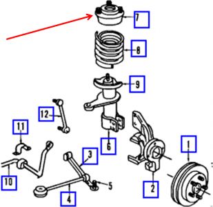

When I steer to the right at 60moh and above I get a rapid "thump thump thump" I called the dealer and they told me to spray WD-40 on the strut mount? I looked and Im not sure what I'm aiming for. I got the repair history for the car. evidently the struts are not new as i was told depite still being new looking. It does have new tie rods ends and everything else in the front end is still tight, so what is this stut mount that I need to juice up woth WD-40?

Hello - akamario, I have attached a pic of the mount. It is the very top item. I would make sure all the nuts/bolts are good and tight with the weight on the wheels. Ball joints can be an issue too. But.....I am still going to go back to that high speed balance on the tire thing. All 4 and then if you still have the sound move the rear to the front. You would be amazed at noises etc that tires can have/make.

I had all the tires rebalanced, nad you are right about that. The tires that were on the front i moved to the back and thats when all these problems started coming up. The tires that were on the back are almost new, I discovered one rim was bent so I have a spare on for that one currently. The other almost new tire was on the drivers front, and I was still getting a terrible shake in the wheel... but that one balanced out ok, so I took that one off, and stole another spare off of my Dad's Concorde. I put the original tires that were on the front, back on the front, and it runs much smoother that it did. the only noticeable problem in the front end now is the thumping. I plan on putting new tires in the car once I figure out these suspension problems. So for now there are 2 old tires on the front and 2- spares ( full size spares) on the rear axle. And I am looking for some used wheels that match the originals. I have not dismounted the almost new tire yet to check it out, either the rim is slightly bent or there is a tire problem that I cant see with the naked eye. I'm going to take the tires to a shop and have them look at them.
