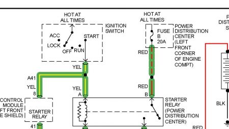

I went out to my car today to got to work and when I turned the key all the lights on the dash lit up but the car wouldn't turn over. No Click no nothing It seems I have plenty of Battery and plenty of fuel. The last time it did start it was kind of sluggish turning over. could this be the starter or the fuel pump?

Could be battery connection/ignition switch/park and neutral switch/NSS, starter relay and starter.
but the car wouldn't turn over. Do you mean it cranks over and refuses to start or won't crank at all?

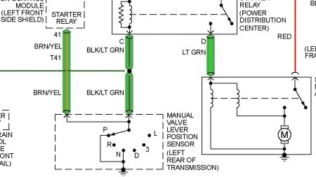

Posted: Mon Apr 07, 2008 11:39 pm Subject: chrysler new yorker 1994 It won't even crank over not click no sound at all lights just lit up on dash when I turn the key Hold key at start position and look for power at the starter solenoid wire light green if its there bang on the starter if it kicks over-replace the starter-no power at solenoid back track it -see below starting circuit
https://images.2carpros.com/forum/automotive_pictures/12900_s1_6.jpg
https://images.2carpros.com/forum/automotive_pictures/12900_s2_6.jpg
