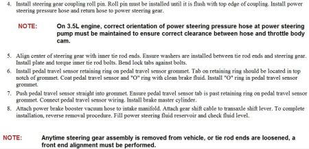

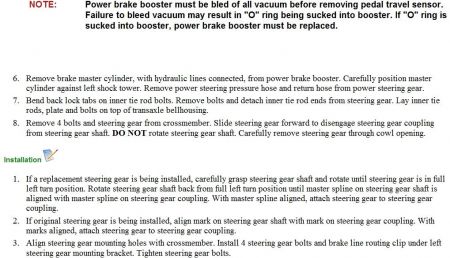

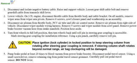

I was just wondering if there were any tips or tricks to properly installing a new rack and pinon to my 1994 Chrysler New Yorker. I installed one already but it didnt give me full steering, I think it was the wrong part, but I am also wondering if theres common mistakes and or tips to make this job a little easier.

https://images.2carpros.com/forum/automotive_pictures/261618_Noname_2489.jpg
https://images.2carpros.com/forum/automotive_pictures/261618_Noname2_814.jpg
https://images.2carpros.com/forum/automotive_pictures/261618_Noname3_297.jpg
